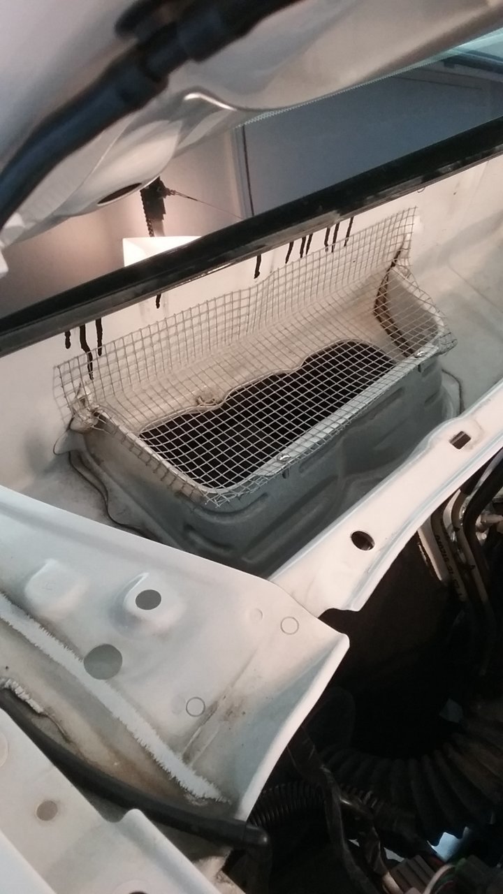

    I'm trying to clean out rodent infestation inside ducting against firewall under dash. I pulled the fan motor and it was full of debris. The ducting leading into also full of debris but cant get to it. How or what can be removed to clean out that area?

    Remove the wiper cowl. It's fairly easy, just remove wiper arms and carefully remove the cowl.

    you can also remove the blower motor if you haven't already
