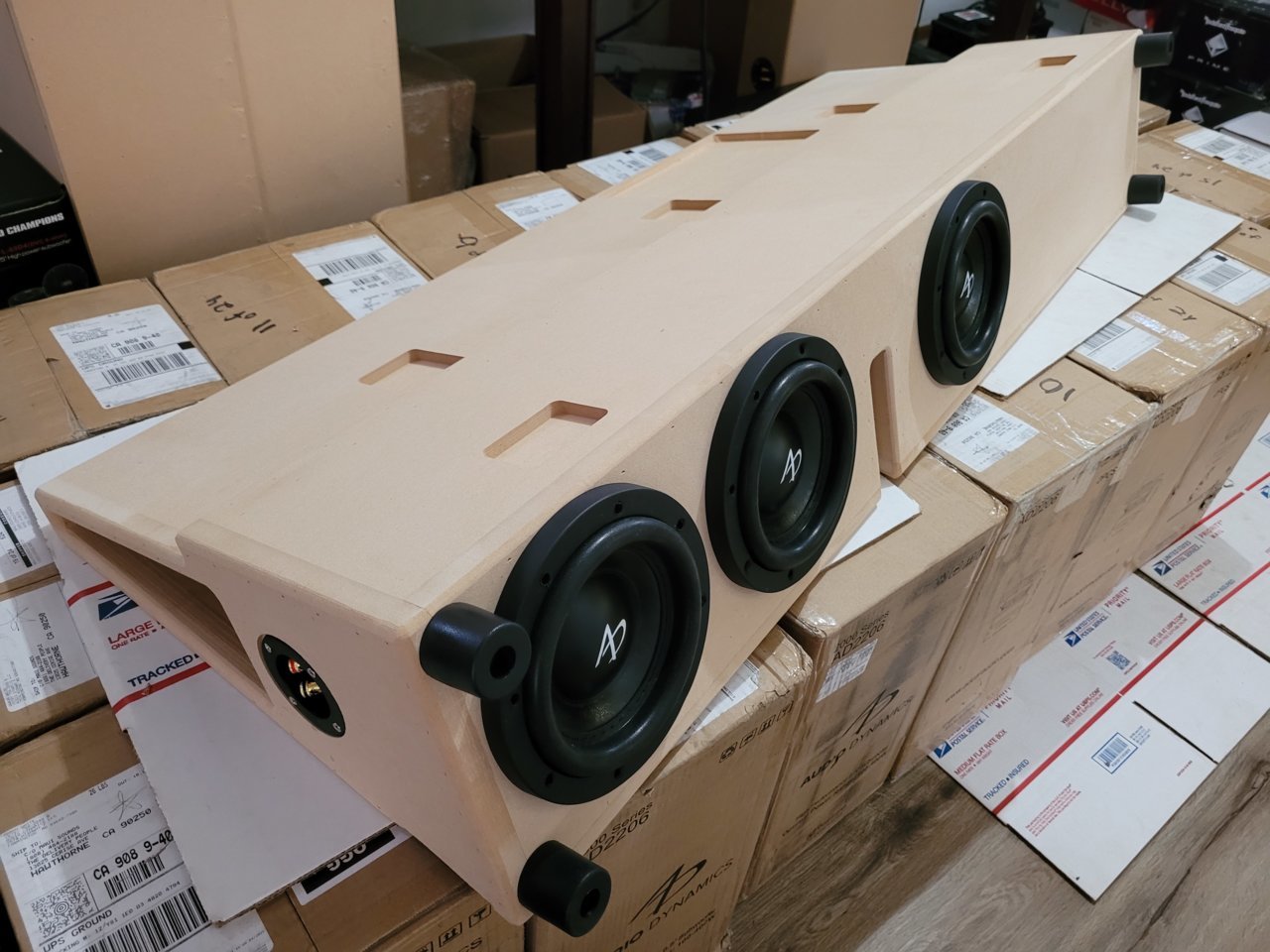

    I'm sure you could shoot them an email and ask about the tuning frequency. I didn't see the ports in that picture. Where are they located?

    Did you look good in the pics man? The ports are in the middle.

    I saw the pic, but can you show me on THIS picture where that is? I don't see an exit. I was thinking it has to be up high somewhere because the area is already short on mounting depth so there's no way you would put it behind the subs.

    nevermind i just saw they are using a square vent that wraps around. Didnt see pinktacos diagram.
