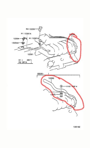

ventilation hose no 2. part number 12262 62060

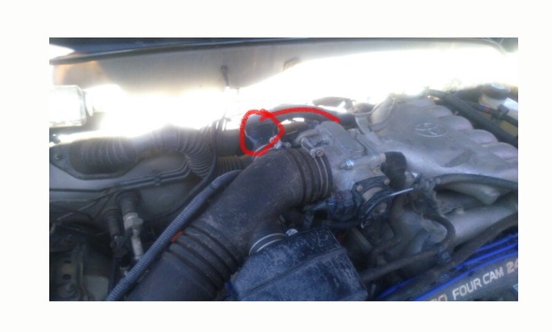

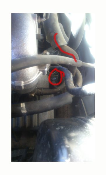

    So question is does anyone know what this is, and whats it for. hose going from little plastic deal on the intake tube to driver side valve cover. Second pcv valve? It has oil residue in it, not bad but a little amount.

    that one is open on mine as well. possibly pre-03 TB setup? ours has the ETC-s (or w/e the letters are) and a motorized assist on the back of the TB

    i knew i should have clarified. I ONLY REMOVED THE HOSE FOR THE PIC. I put it back on afterwards.... Whats an "ETC". I did start the truck and removed the hose on the intake tube side, and noticed the rpms went down a little, but only like 50 rpms.that was while the truck was in park..

    I was talking about the tiny one on top of the intake for the first pic you circled.

    That is the filtered air "source" for the PVC system. It's the fresh air that "ventilates" the crankcase/valve cover areas.
    In theory, air is continuously drawn thru the the engines internal voids (driver valve cover>crankcase>pass valve cover>PCV valve>little hose to manifold) by manifold vacuum. This flow is metered by the PCV valve and is intended to carry any oily gasses that leak past piston rings and valve guides along with it to be burnt in the engine.
    Oil present in that hose indicates the engine is producing more of these gasses than the PCV valve will allow thru. Hence the excess gasses back up and condense in the tube.
    Could be a sticking/clogged PCV valve and/or a restriction/clog in the little hose from the valve to the manifold and/or worn rings/valve guides. Extended high loads or "spirited" driving can also cause a temporary back up and leave a little tell tail oil trace.

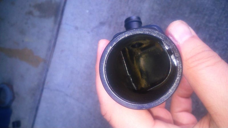

    Not all 3.4's have that little box between the hose and the main rubber intake tube. I believe that box is a catch can of sorts intended to catch this "nuisance oil". I have never seen one close up but it might be constructed to catch/condense the oil and let it drain back down the hose into the valve cover. Maybe one of you folks that has one could make a close examination of it and see if that's reasonable.

    I think your right, i think that is a "toyota" catch can, albeit a very crude one that doesn't seem to catch much. I already bought a catch can for the actual pcv system, should have it installed next week, if all goes well. Would it hurt to have two? Even under the theory of a closed system..? Not something I plan to do, but its an interesting thought. Oh and on another note, after a failed 5 month old O'Reillys pcv grommet, i think ill start using oem..

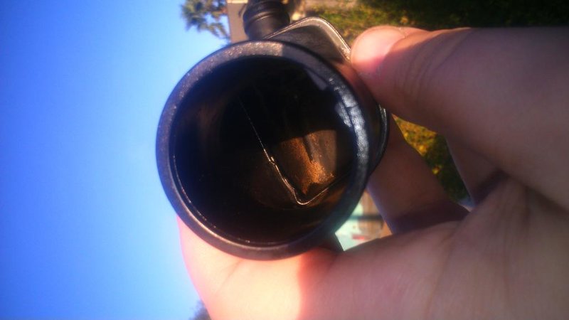

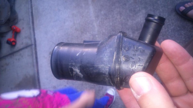

    So, for those who care, heres a pic of that little plastic piece on the intake tube right before the tb on an 04 dc prerunner, the "catch can" if you will.

    From the placement and elevation of the "little" hose connection on the box, it sure looks like any captured or condensed oil would drain into the main intake hose instead of back down into the driver side valve cover.
    I'm thinking the box may have more to do with mitigating some effect the pulsing nature of the main intake air stream has on that end of the PVC system. Hard to say.

    What Dirty said. Post 22 on the 2nd page of this thread has the PN's you need. Also, this thread is probably the best as far as info for valve cover gaskets and related stuff.
