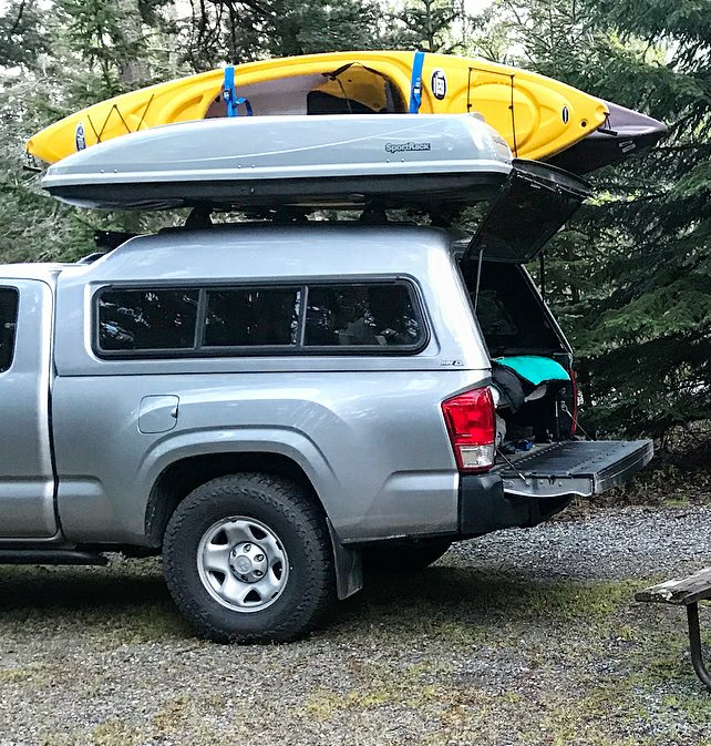

    I know not exactly what you want but here are our MX caps
    gugman[OP] and Jleeb[QUOTED] like this.

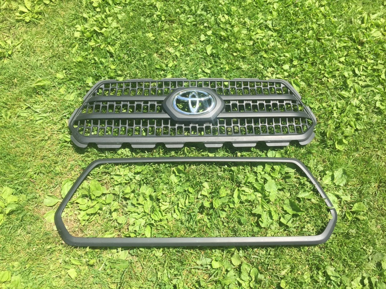

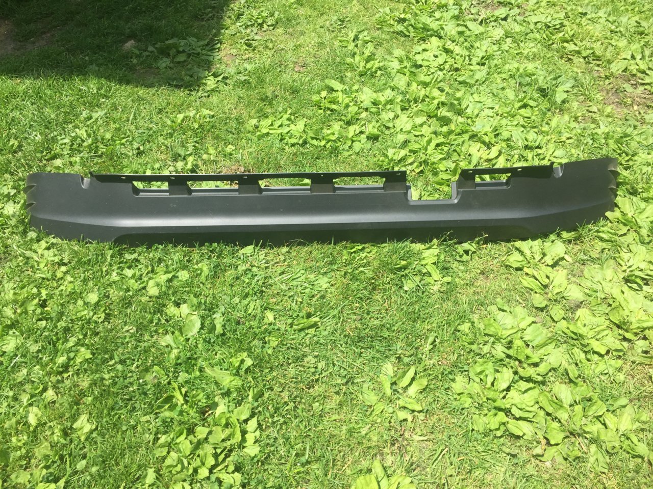

  15. Jun 16, 2018 at 10:21 AM
    #2315
    TRDtacomamr2
    TRDtacomamr2 Well-Known Member
    Dec 1, 2016
    #203813
    259
    JOSH
    Vermont
    2016 trd tacoma sport 6 SPEED
    Hey guys I have a few things along around from my 16 tacoma. Front spoiler 80$ oem running boards 400$ oem grill painted black 100$ rev tek bumper bar 125$. All for sale for best offer.
