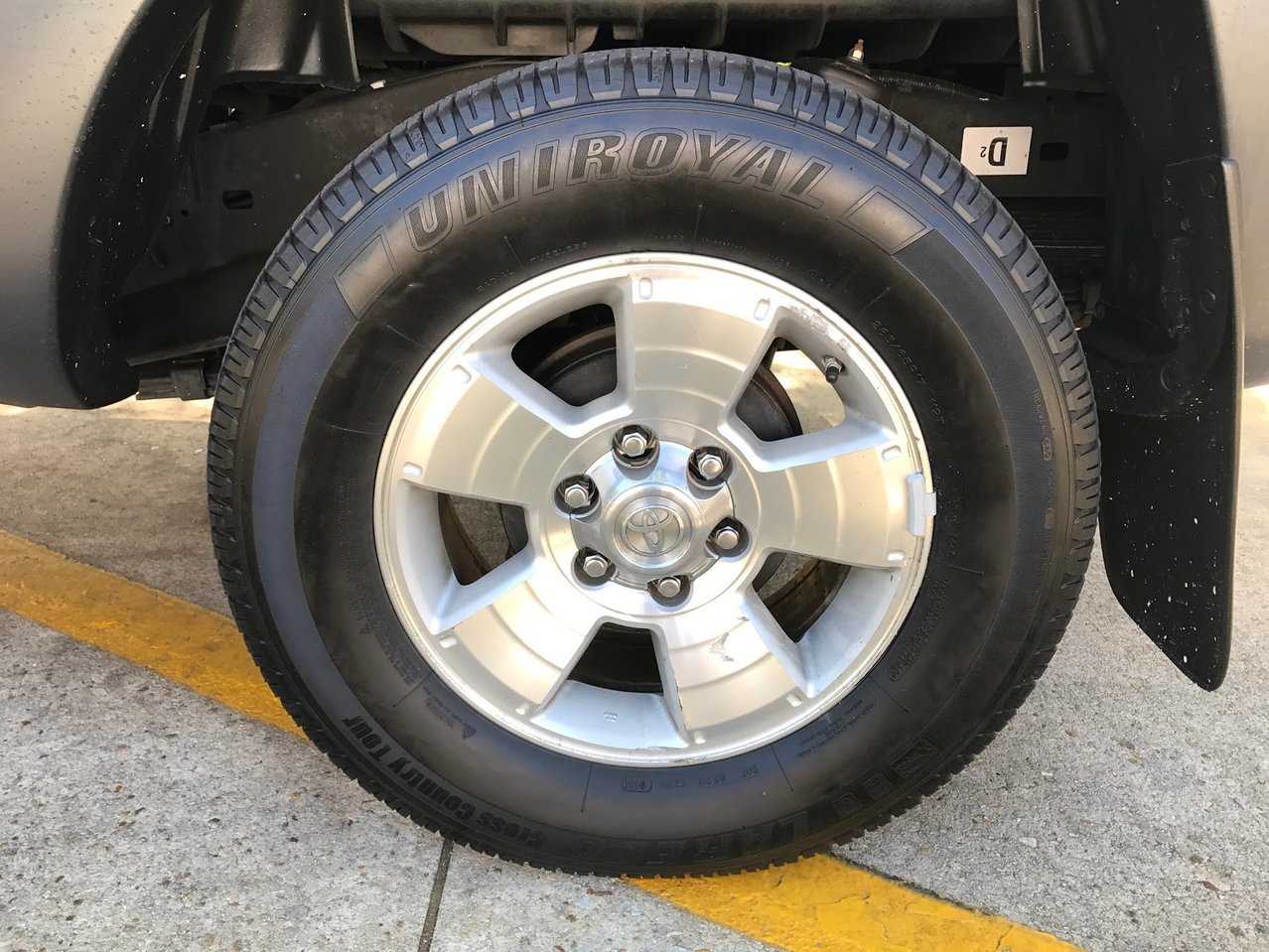

    Truck has 43xxx miles. Tires are UNIROYAL 265/65R17 112T. The wheels are Toyota rims, not sure what kind.

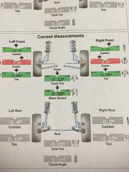

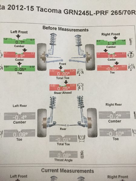

    This is the before and after. They couldn't adjust the caster cuz of seized cams like everyone was saying.. they said everything will be fine and won't cause any uneven or faster wear.

    Rough, sorry to hear man. But aftermarket UCA's will help quite a bit to improve those numbers and are far cheaper than doing work on/replacing the LCAs. It all comes down to your comfort level with the current situation. Did the shop seem like they knew what they were doing given the aftermarket setup?

    It seemed like they did but I can't really be sure, he just said I shouldn't see any odd wear.. I only run these wheels from now to about October..

    I see. The guys in the thread you started have had their lift setups for quite a while now and can better tell you what to expect for tire wear given the alignment results.
