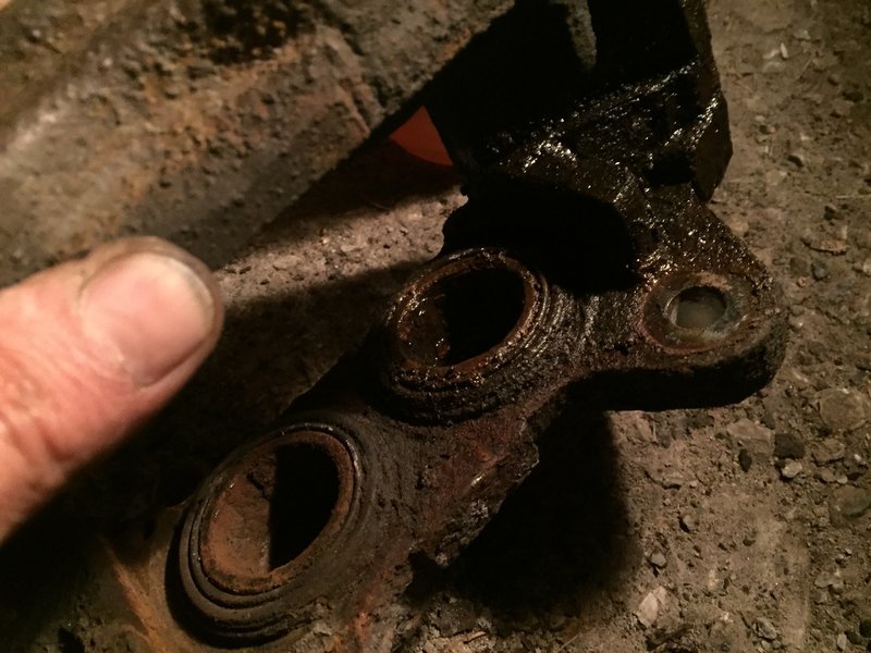

    Here's the guilty party!!
    Dirty bugger!

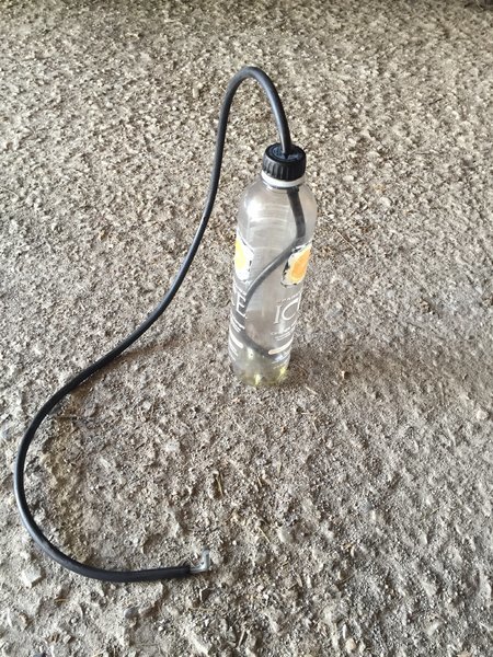

    So I did the calipers last night did both sides. Just did a gravity bleed on all four brakes. Didn't have anyone else here. Back together at 10:30. Not bad if I do say I'm really not set up that well but 3 1/2 hrs.
    Rigged up a bleeder bottle this am and wrapped it up.

    Not sure who does most their own maintenance but.
    I saw this and made one for bleeding/flushing brakes.
    Worked like a charm easy peasy.
    I used 5/32 wiper tubing and a bottle in the recycling bin.
    Instead of bleeding brakes I got rid of the old stuff and pumped new fluid in.
    Anywho I had a great time doing my brakes I enjoyed my time with it and how easy it is to do this, even with my low tech knowledge.
    And I would recommend the power stop brakes. I have the drilled slotted rotors and ceramic pads. At like 20k they looked liked new after cleaning.
    Pretty quite here in town considering we are the main st detour and the maple festival is going on.
    This bottle allowed a 1 person bleed. Gotta make sure you start with fluid in the bottle above the tube so it can't suck in air.

    Glad I didn't have the bronze trd wheels on when the caliper piston let go. Brake fluid is nasty nasty stuff.
