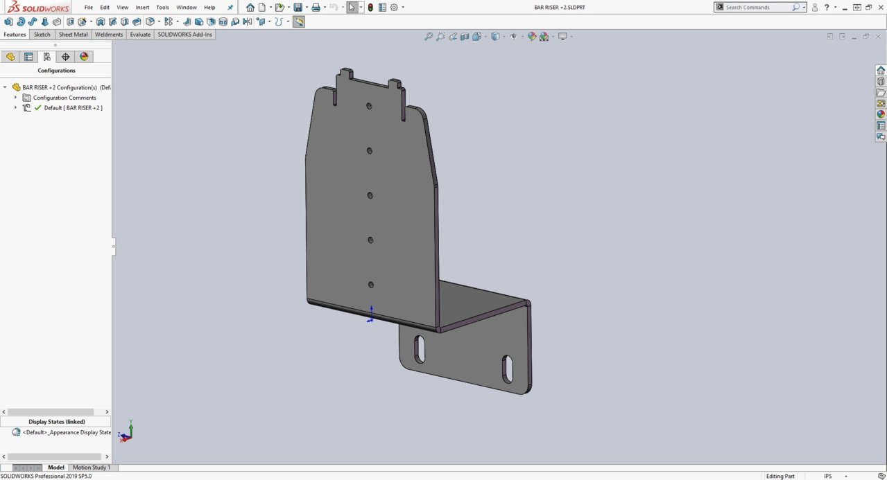

    I've looked into doing this but you can't extend the bottom leg of the bracket because it would lift the horizontal leg that rests on the bed rail upward. It needs to be a new entire bracket that is taller on the upper vertical leg or a very ugly vertical leg extension piece (unless I'm missing something). I've drawn one up in SolidWorks that is 2" taller but haven't quoted laser-cutting and coating it yet. I do also wonder if being taller will create other problems.
