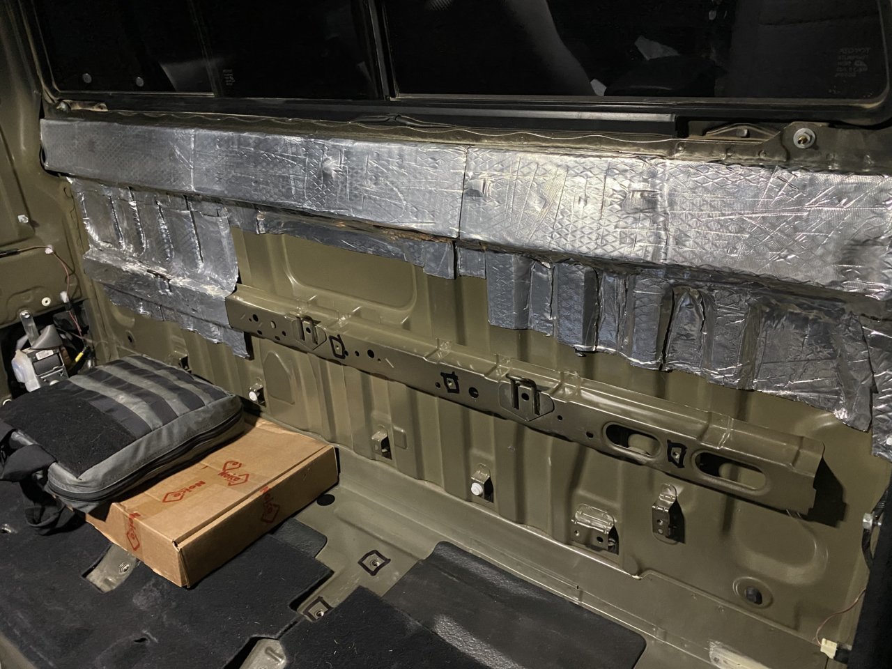

    @Jpeg1900 there isn’t room in back wall of the stock cab to add a vertical sliding window.
    Here is my truck with the seats and plastic bins removed. F9A748B4-DF9B-4F8C-84B4-548D3BE8C5AA.jpg
    The vertical ribs are the same surface that you see from the outside when the bed is removed as you can see. CF1F67F3-75AC-4972-B736-701445A1D1B8.jpg
    You would need custom glass, a custom pocket for it to retract to, and all the mechanism to retract it would have to be custom fit.
