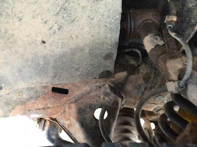

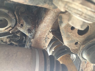

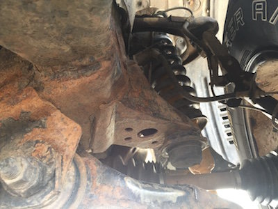

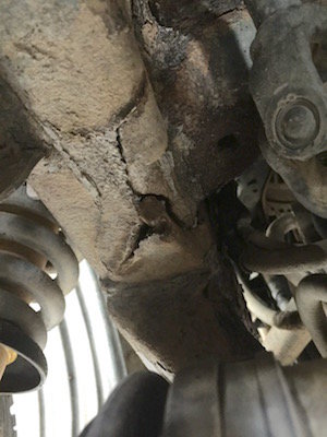

    OK, I know there's a ton of stuff on here and I will get caught up ... that said ... this sucks and I need any insights I can get.
    Heard the fan hitting the shroud last night. On inspection today I find that the frame under the left motor mount is rusted through and collapsing.
    I bought this 06 DCLB from a VT dealer last March. I emphasized my concern about the frame at the time and they said it passed all inspections. Fast forward 10 months and I'm sitting on a very bad frame.

    just saw your pic, yes you need a loaner and a new frame, good luck.

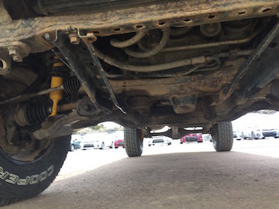

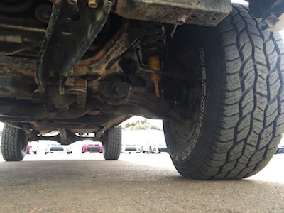

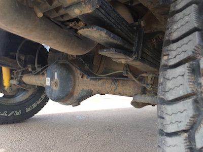

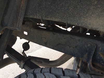

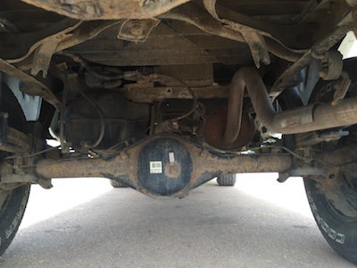

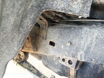

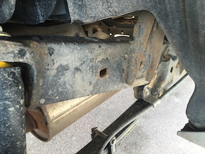

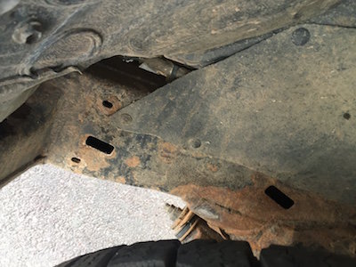

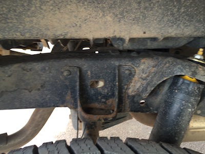

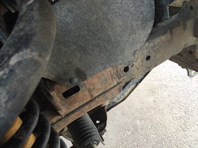

    Here's the good bad and ugly. I thought it just looked bad and could be treated by me slowly and methodically. Apparently not ...
    and of course ... the critical area:
