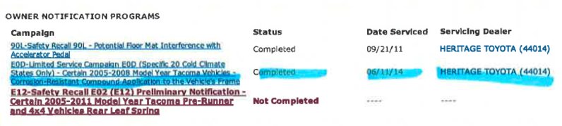

    Is that what vehicles treated with the CRC application under the Limited Service Campaign E0D should look like after 1.5 years?
    :confused:
    From the vehicle service records:

    NM dealer forwarded their evaluation to the Denver Toyota rep yesterday. They said the frame has many more areas of seriously unsafe corrosion. They also said they "would not" drive the vehicle "even if [Toyota] won't replace the frame." Didn't love that. Probably a smart CYA instinct on that service manager's part ... but still feeling uncertain what's ahead here. And I wouldn't drive that frame anywhere again ever - the mount crack got worse in the 1/4 mile to the dealer lot.

    I can tell you that, based on those photos and having my frame recently coated, your frame has not been sprayed with the CRC. Mine was done in early October, it is a super thick gunky coating that is still sticky over three months later. It gets all over my clothes and skin when I get under the truck. You wouldn't be able to see the rust through it if yours was done. I wish you the best of luck. It is hard to believe that they're giving you flak about the frame with the recall going on. It is the quintessential representation of why the recall was made in the first place.

    UPDATE:
    Visited the truck today ... up on the hoist ... frame is straight up rotten. NM dealer said there is no way it is safely driveable at this point.
    NM dealer is generally pushing it off to Toyota corporate in Denver who is, in return, offering no coverage at this point. NM dealer is putting in good faith efforts without being optimistic at all. The service manager is interested in the 3/14/2015 email from my VT dealer salesman saying plainly that have a 10-year rust-through guarantee. I will be forwarding that to him tomorrow.
    VT dealer is trying to wash their hands of the whole thing and say there is zero coverage after the CRC treatment in 6/2014. I am going to have a very serious conversation with the general sales manager tomorrow. Astonished no manager has offered apologies or any other proactive anything at this point. The only reason I kept this truck after the bumper came partially off on the highway while towing :eek: and I expressed high doubts about their inspections ... is because the salesman said plainly that I had the coverage for the frame treatment. Otherwise I would have driven it right back to their doorstep and washed my hands of the truck.
    Heritage Toyota in South Burlington Vermont is NOT backing, in any way, a clear statement of coverage made in writing by their salesman. This, after the vehicle already had a serious safety issue that was fixed under emergency conditions. Within a week of purchase based on their reputation and 160-point Quality Assurance Checklist.
    Toyota corporate is not rushing to update me on anything. Somewhere in the mix, I did get an Toyota Corolla from Enterprise rentals that NM/corporate is covering. But that was made to feel like a consolation effort and in no way an indication of progress on the frame.
