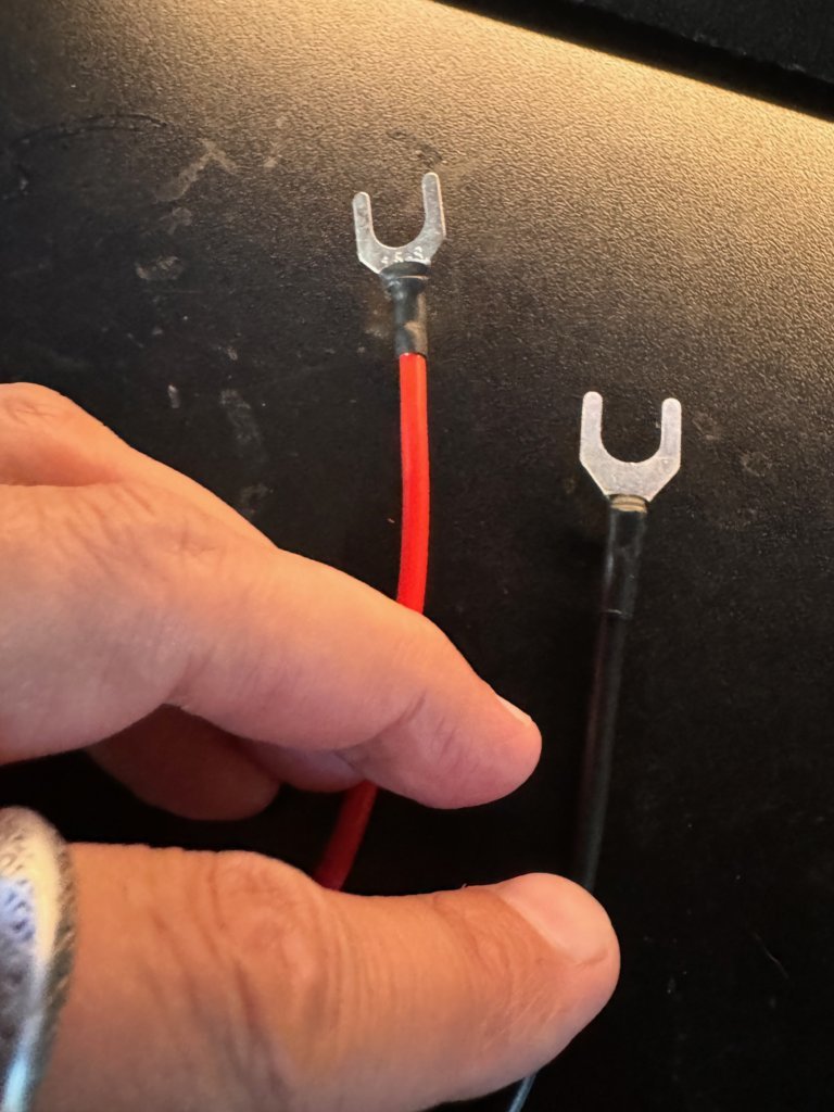

    Show me the DD harness. If it's already got it's own ground (as most do) then you don't need a ground to trigger the relay, just +12v and a single lead. If it has a ground input then you would, but presumably it sources all grounds for high current and the relay coil off a single hoop.
  13. Sep 5, 2024 at 3:57 PM
    Wheever
    Wheever [OP] Member
    Jul 9, 2024
    #453014
    13
    '21 TRD PRO
    It does indeed have a ground (As pictured.) It pulls voltage directly off the battery, and has an inline fuse on the positive. (As it should.)

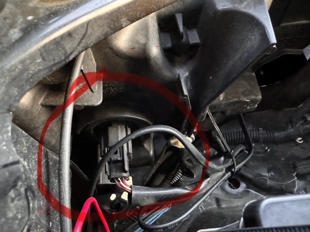

    Post a photo of where/how you intend to splice in the high beam lead.
  15. Sep 5, 2024 at 4:09 PM
    Wheever
    Wheever [OP] Member
    Jul 9, 2024
    #453014
    13
    '21 TRD PRO
    Frankly, I was hoping to pull it off the driver's side headlight plug, (pictured) as it's the most easily accessible location. I would, of course, take any other advice.
