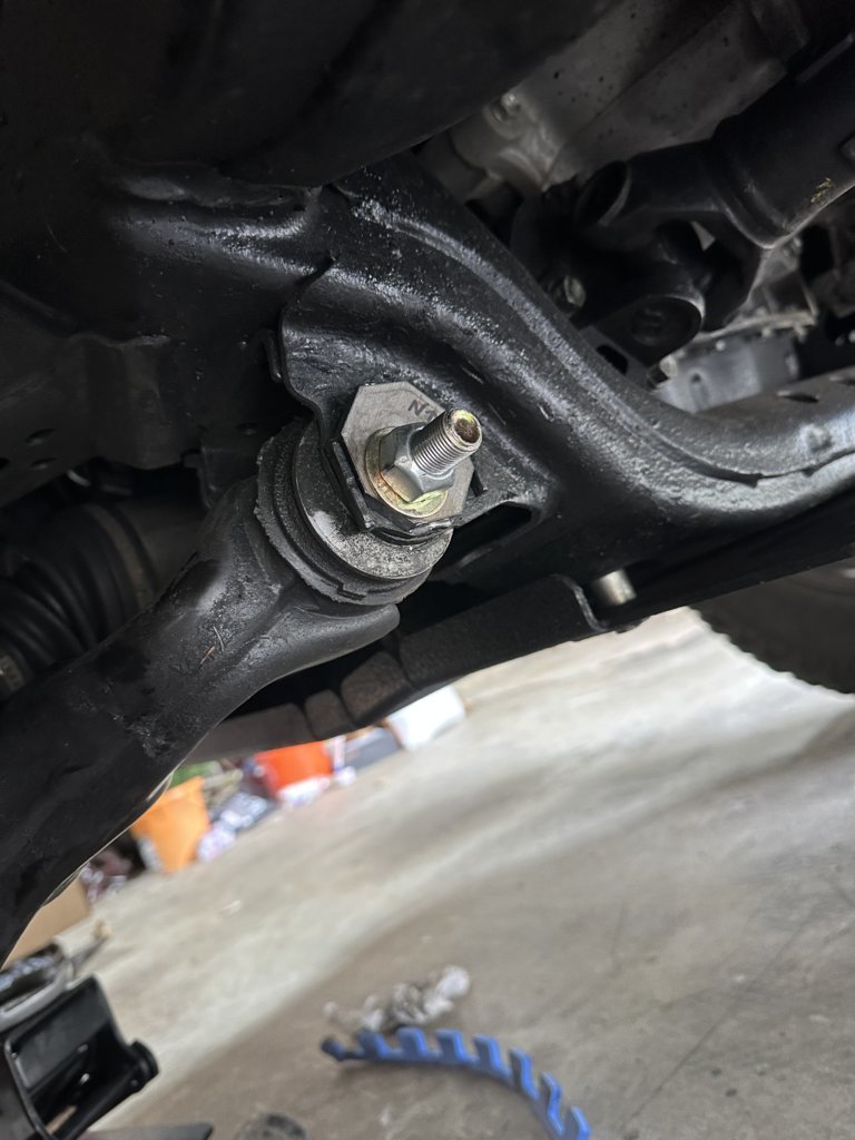

    Thanks Eric - Do those new bolts/octagons eliminate the need for tabs? There's "some" tab left - but worn down. The popping/banging was likely the cam spinning over the tab then slamming back into place.

    No but you can but the kit with new plates though you’d have to weld them together.
    I’ve got the tabs as a back up but so far, I’ve not seen any movement with just the plates and bolts.

    Very cool - thanks for the info, Eric. I think I'll head down that road.

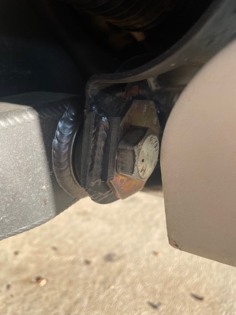

    cam tab gussets give the octagonal cams a bit more to bite on to. these are the DK tab gussets and Bison fab cams

    I should learn how to weld-

    You and me both. That ain't my work haha
