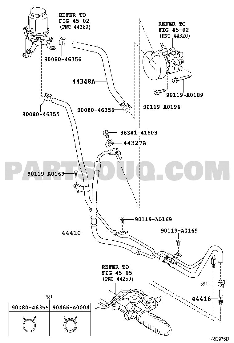

    Upon further inspection and verifying with my mechanic neighbor. it's the return hose that's bad anyone replaced this before??

    I mentioned "return hose" in post #20 because it's a common problem on Toyota 2GR-FE engines(6 cyl transverse- mounted used in 3rd Gen Avalon's and many Camry's, Rav4's; Sienna). On those cars - a people have reported using 7/16'' hose and others 3/8" hose as a replacement. 2GR-FE setup requires you to buy entire metal return line assembly just to get a relatively short length of OEM hose. Go to:
    http://www.partsouq.com
    provide your VIN and go thru diagrams. See if Toyota has an OEM replacement for the 1GR-FE return hose. I use this site for parts number lookup only.
    Went ahead and checked it out - curiosity. Not surprised. No separate return hose:
