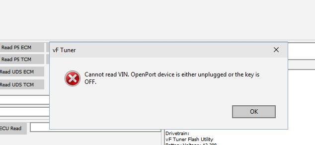

    Need some help with flashing. First, I have had VF tuner for for several years and am using the legacy dongle. I have 2017 Tacoma 04B04 ECU. I have not flashed in a while. I was attempting to flash a new tune with adjustments for an AGM battery. The flash failed. Now my truck will not start. When trying to prepare the ECU to attempt a flash I am now getting the error message below. Any advice?

    Issue resolved thanks to help from Triple C Chop Shop. Still not sure what caused it though. Had to use Gen2 force flash with stock tune to get back up and running.

    Glad it was a quick and simple resolution. It’s scary bricking an ECU.
