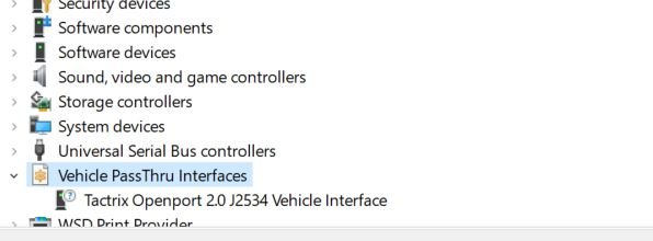

    For the life of me, I can no longer get the Flash tool in vfTuner 1.6+ to connect to my truck. The ODB connector has lights changing from blue to red to yellow, and the laptop detects the cable (per device manager), but it simply will not connect and read the ECM. I've tried reinstalling the drivers and VFtuner itself, but nothing is helping. Techstream isn't able to connect either.
    I haven't flashed my truck in more than a year. Did something change in the Windows 10 OS during the last year that might affect connectivity? Anything that might prevent my ODB from connecting?

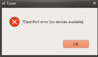

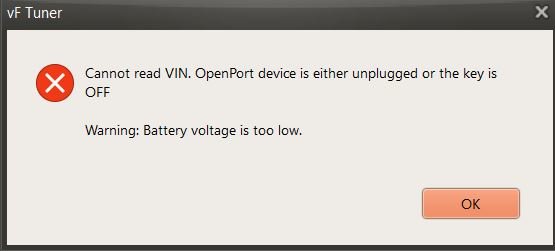

    Good thinking. Unfortunately, just tried a second cable and that doesn't seem to do the trick. I know there used to be a few known issues with USB 3.0, but this is the same laptop I have used to flash my truck for several years now. The only real differences are a few updates for Windows 10 over the last 12 months.
    Errors alternating between these two messages:
    However, the drivers do appear to work in Device Manager:

    All fuses good to go?
