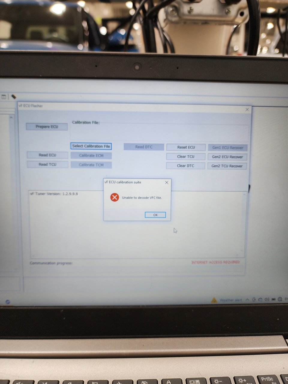

    Can anybody tell me what im doing wrong please lol.

    It doesn't look like you hit Prepare ECU?
    Also, that looks like a way old version of vF. vFTuner often nukes older versions from working to encourage folks to update.

    ^ this
    update to the newest version. Might have to grab it from the website

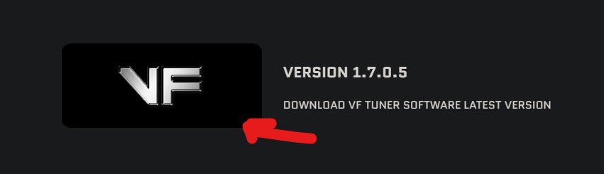

    He still has not added the requested note that the logo is the link. Not very obvious.

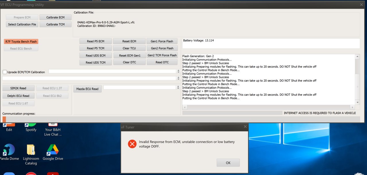

    Diamond Back HD, full interior light change, DiodeDynamics main lamps, Caliraised amber fogs & ditches, Caliraised 25 Degree sliders no plate, SSO slimline front bumper w/ 20" LED Smitty Gen3 winch, Barricade rear bumper with rear in bumper lights from SuperbriteLEDs, Budbuilt rock 2 plates with rerouted exhaust, Method 306, 295 Ridge Graps. OEM Kings tuned from Filthy, Deaver Exp 1, SPC UCAs, 5.29 diffs. Dash mounted 1/4 threaded accessory plate. And a TRD Pro grill...assuming I qualify for pro status.
    Glad to be back with a few new tunes to flash but getting an odd voltage too low error. All voltage readings are solid. Posting a screenshot of the error. I keep a dedicted laptop for this sole purpose so it stays at the ready. Ideas or workaround?

  14. Mar 25, 2023 at 2:46 PM
    #414
    Shellshock
    Shellshock [OP] King Shit of Turd Island
    Nov 21, 2015
    #170338
    23,599
    Iowa
    It shows your voltage at 13.1 which should be fine. I’m guessing it’s hooked up to a charger? Maybe it thinks it’s too high?

  15. Mar 25, 2023 at 3:03 PM
    #415

    Feb 18, 2019
    #283513
    75
    Brent
    Atlanta, GA
    2018 TRD Off Road 4x4 DBL 5.5
    Hey thanks, yeah voltage was 12.7 or so when i started and i threw the CTEK charger on to be safe but that wasnt it. Ive rebooted, reinstalled drivers, etc. to no avail. Same error. Utterly ridiculous

    #419
    Teamrivers
    Teamrivers Well-Known Member
    Feb 18, 2019
    #283513
    75
    Brent
    Atlanta, GA
    It's a head scratcher for sure. I did a full uninstall of software (I had installed the latest version over the top of a previous version) and uninstalled all drivers. Started fresh and the AGM battery is topped off at 12.8. It still gives me an invalid response error. I've had nothing but issues with every flash I've done.
  20. Mar 25, 2023 at 6:18 PM
    #420
    Teamrivers
    Feb 18, 2019
    #283513
    75
    Brent
    Atlanta, GA
    I guess if I took time to RTFM, I'd have realized pressing the R7F Bench flash button, which is new for me compared to the last version I used, that would yield an error. Calibrate ECM...repeat, Calibrate ECM button is the one to press. All good now. Matt replied to my support request. :)
