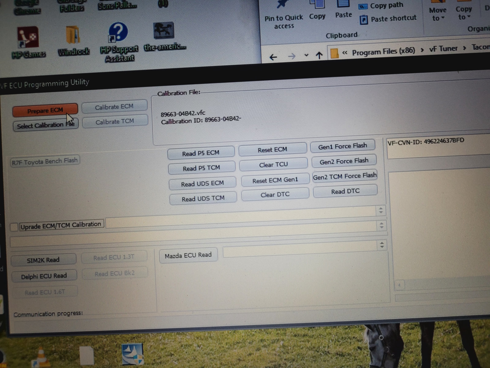

    I've tried this a couple times but can't get past a certain point. I'm at the step "calibrate ECM" but the button is grayed out. Also, I'm not actually looking to flash a tune at this point, just trying to get VF Tuner up and running. I've had OV Tune since 2019 and just want to switch over. I don't remember having any trouble with the learning curve on OV but VF has stymied me to no end. Pls help.
    Pic for reference:

    Texoma IG: Triple C Chop Shop
    Feb 1, 2011
    #50374
    18,966
    Chris(Topher)
    Lago Vista, TX
    10 Taco 4x4
    A bunch a cool stickers, a bada ass MetalMiller Tx Longhorns grill emblem painted Hemi Orange, JBA long tube headers with o2 sims, Diff breather mod, Red LED interior lights, Fancy head unit that plays ipod n movies, Also DIY install factory stuff like, factory cruise control, factory intermittent wipers, OME nitro struts with 886x springs and toy tec top plate, JBA high caster UCA's for better alignmnet and dey beefier too, Old Man Emu Dakar leaf springs in da rear with the gear, U bolt flipper, Ivan Stewart TRD rims with 33" K Bro 2's, some bad ass weather tech floor liners so I don't muck up my interior, an ATO shackle flipper for mo travel in da rear wit the gear, also super shiny Fox 2.0 shocks back there too, all sorts of steal armor for bouncing off of the rocks like demello sliders, AP front skid, trans skid, n transfer skid, demello gas tank skid, and a tough as nails ARB bumper with warn 8k winch, I'm sure there's more
    ignition on, but motor not running
    dongle plugged in to obd2 and computer
    click prepare ECU
    select calibration file
    flash ECU will be available
  16. Nov 3, 2023 at 8:25 AM
    #436
    TacoTunesday
    TacoTunesday Well-Known Member
    Jul 13, 2022
    #401278
    134
    Tony
    Go ahead and click prepare ECM. Your cursor is right on it. The steps Texoma posted are accurate.
  17. Nov 3, 2023 at 9:03 AM
    #437
    Trim taco
    Trim taco Just one more stupid question
    Oct 8, 2013
    #114070
    878
    Bourbon capital of the world
    Was: 96 SR5 5MT Is: 19 OR 6MT
    Bunch 'o random stuff
    I'm already past that step. At this point calibrate ECM should be available. Should I repeat prepare ECM?
  18. Nov 3, 2023 at 9:05 AM
    #438
    Trim taco
    Oct 8, 2013
    #114070
    878
    Also, to be clear, I'm not trying to flash a file. I just want access to the software. Right now I can't modify or moniter anything.
  19. Nov 5, 2023 at 4:50 AM
    #439
    Trim taco
    Oct 8, 2013
    #114070
    878
    I don't know if this will make me look like less of an idiot or more of one. I realize now that I should have skipped past the flash directions and read down to the the section where you actually use the credits to unlock the ECU. I'm not sure why that isn't the 1st part of the directions, but maybe my brain is just wired backwards. It seems like that's putting the cart before the horse. In any event, thanks for the attempt to help this old caveman.
