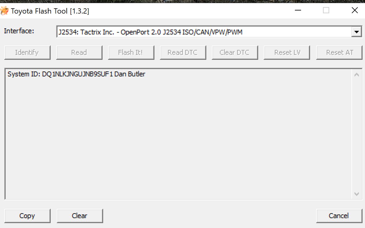

    I was a OV tune owner prior to vf, I downloaded the new toyota flash tool version to flash the existing premade 2.0 files, does anyone have any idea why everything is greyed out here? I know probably a stupid question

    Check the system ID shown and the one for your reg file. Likely your system ID has changed.

    Thanks, I should have picked up on that. Does this mean i have to request a new system id?

    Yeah you need to request a new reg key

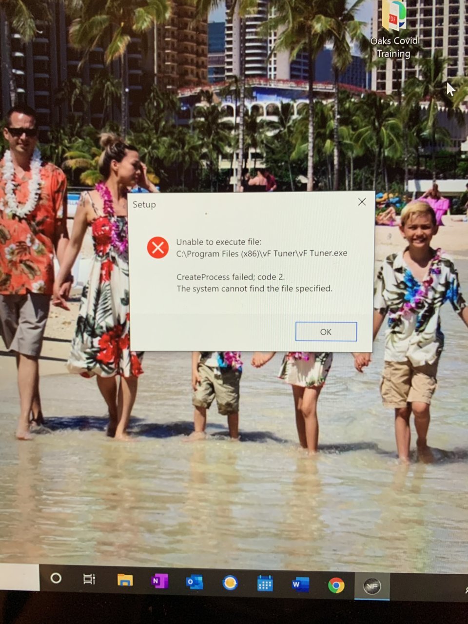

    Trying to download software for the first time. Never able to load for some reason get this error message. Any help would be great I’ve emailed orange virus but no response for a couple weeks figured I would come here for some assistance.
