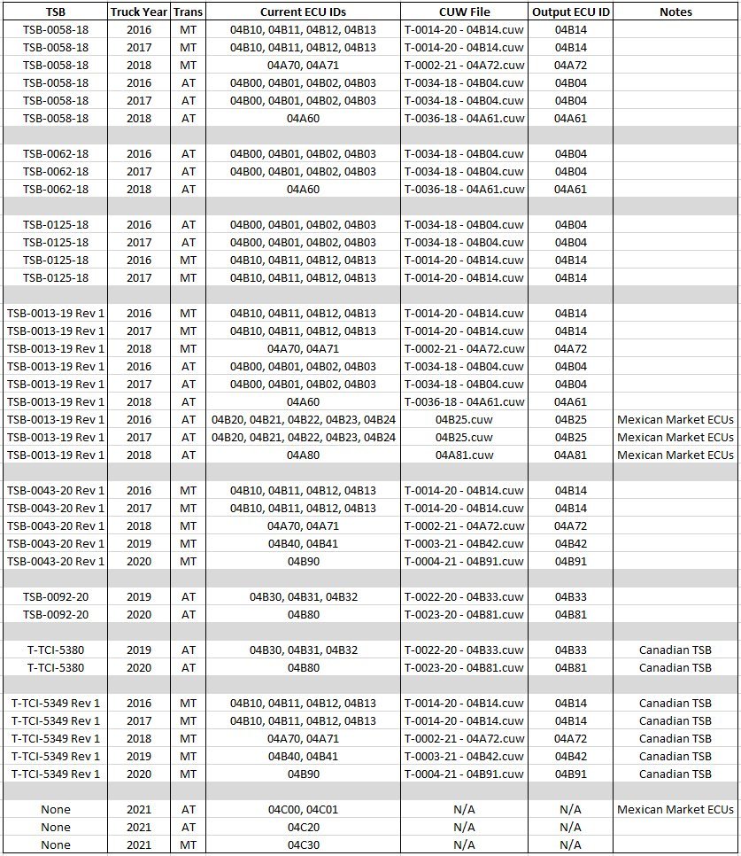

    I would have to Register my Vin Number in order to get access to 04B13 Stock
    Then can I Register the 2021 taco to get tune for that ECU ?
    Just looking to but back the Stock tune , before I give the truck back in

    I have all the files for the old 04B12 but nothing for the 04B13 only the 91 octane
    Thinking my best options like you mentioned updated to the 04b14

    just apply the TSB to your current truck. That will overwrite the tune and it’ll be running 04b14. No need to register or flash the stock file on that truck.
    then you can use your credits to register the new truck and request the tune pack for its ecu

    Yes, recently I had someone else flash my truck and he told me that it was already up to date. my truck is a 16 and the ECU ID is 04B04 which according to the table is the latest for my truck I think

    Yes. That is the latest, but 04B05 is in the wild on new ECUs from Toyota.

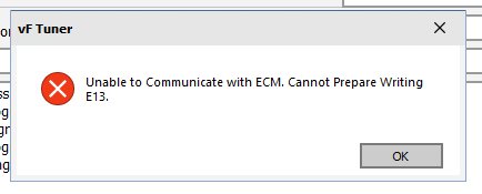

    I'm so close. The VFtuner starts the installation & then an E13 error pops up. can't communicate with ecm. But earlier today it accepted the tsb update with techstream. any ideas? I did email ovtune earlier but they probably wont respond until tuesday or wednesday with the holiday.

    Sorry didn't realize it was posting pic 4 times

    When does this pop up? When you select calibrate ecu?

    It is helpful to see the rest of the Flash Tool window. VIN masked of course.

    It happens quite a bit. You need to either try to fully cycle the engine and ignition on/off 10 times, or go drive it for 10-15mins then try again. Either one of those should clear the E13 error and allow you to flash the tune.
    Edit - wait around 10-15secs between ignition cycles.
