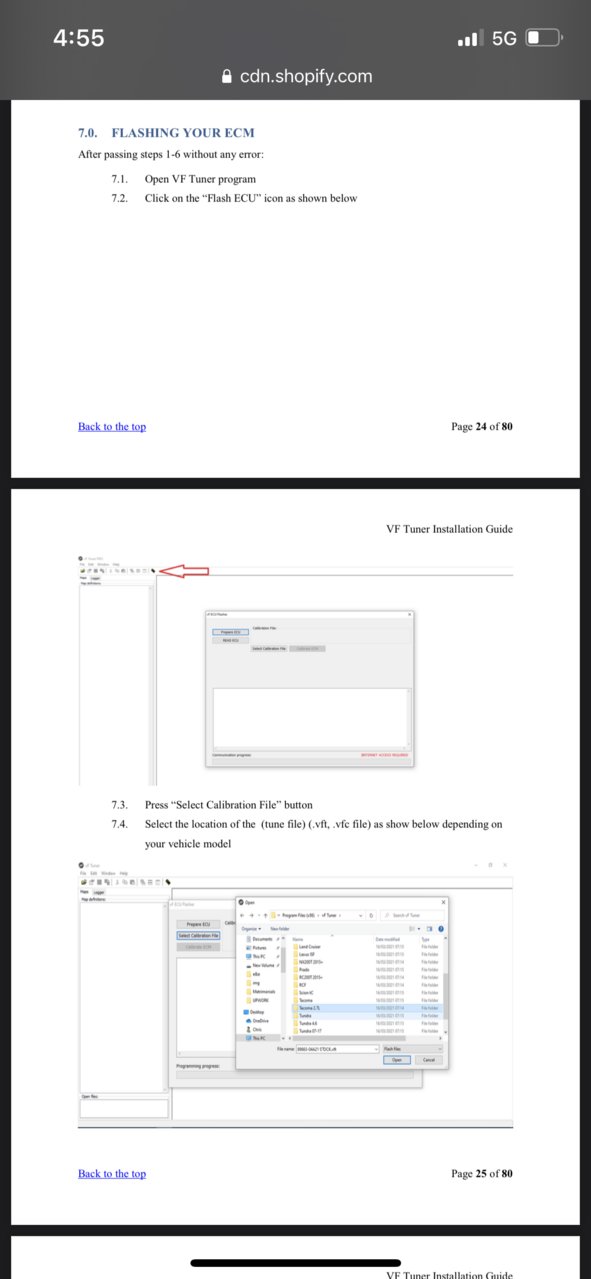

    Looks like there's a step missing in the instructions. This is why I was stuck initially. They omit the "Prepare ECU" step prior to selecting the tune file.

    Good point. The Prepare ECU step is missing there as that is showing a different process than the Licensing steps on Page 20.

    I think section 5 or 6 is for prepare ECU.
