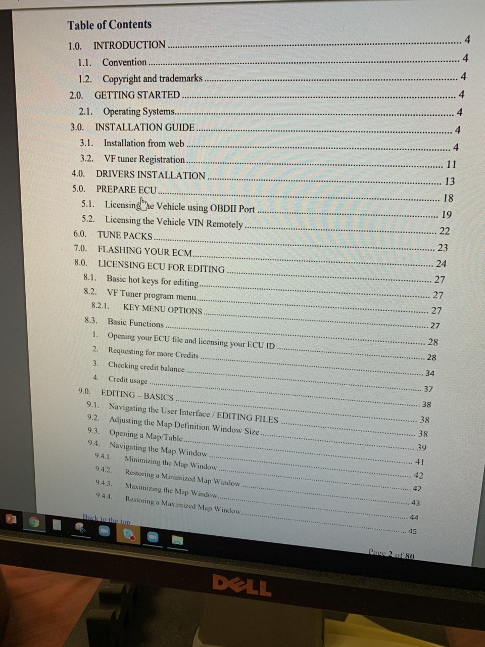

    Dude the first step in #7 says "Open VF Tuner". You still need to click the Flash ECU button, click Prepare ECU, and then select the tune. They miss a step in the instructions here.

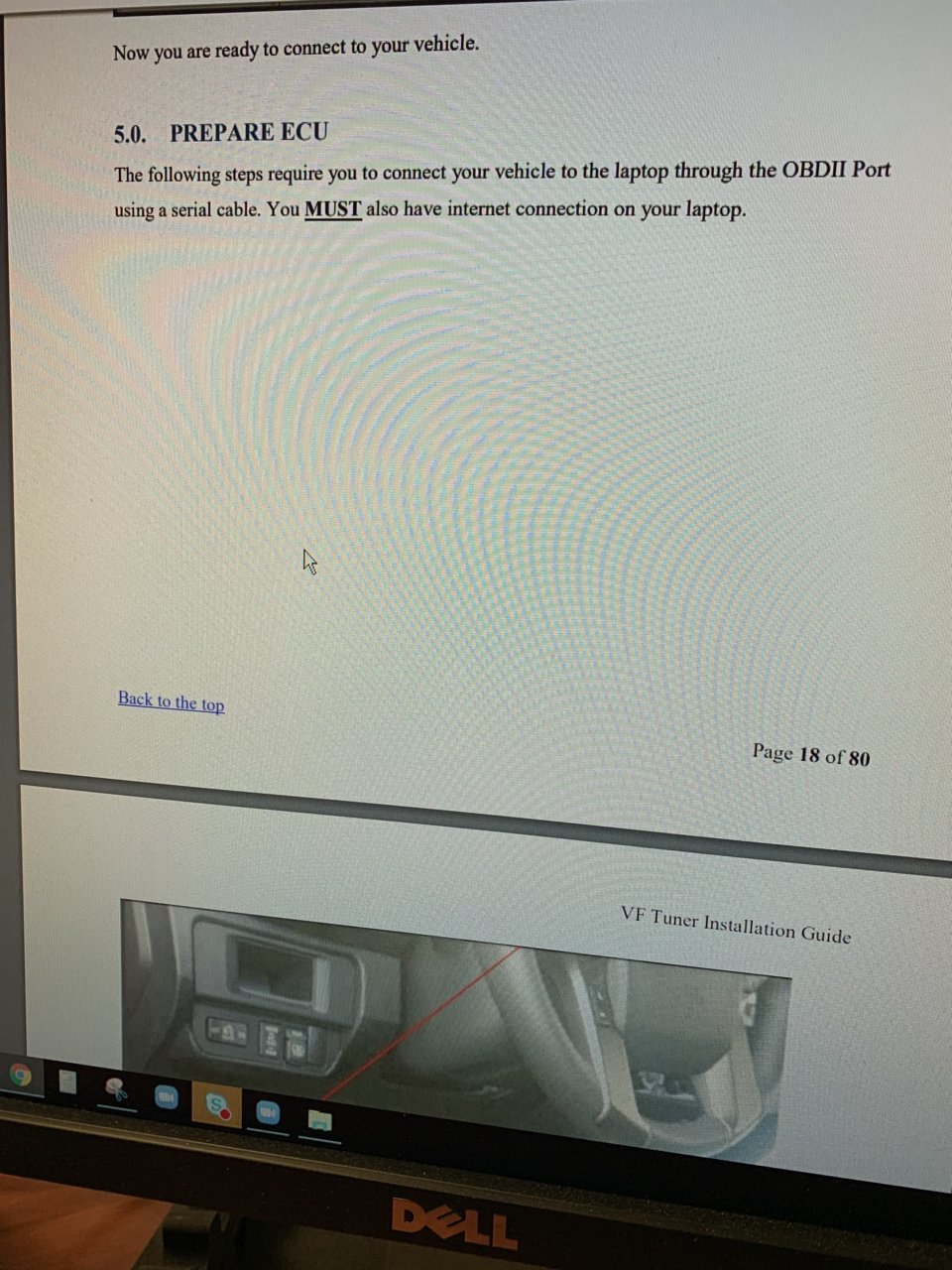

    Trying to help. Instructions are not super easy to follow but it’s there. Sorry for shitty photos.

    Yes I understand that, and I appreciate you trying to help. What I'm saying is, is that what you're pointing out simply isn't relevant here. Anytime you flash the truck's ECU you still need to go through the process that @tonered has laid out twice already in this thread, which is: open VF Tuner > click Flash ECU button > click Prepare ECU button (this checks that your VIN is registered and you don't need 4 additional credits to proceed) > select tune file > flash ECM

    Agreed. Section 7 is stand alone.
