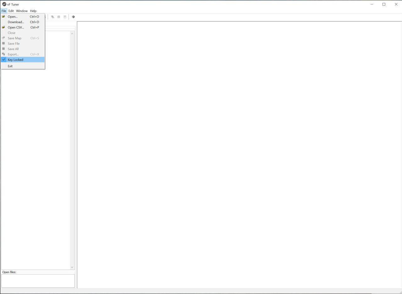

    if you get vfTuner Pro you can lock them
    xxTacocaTxx likes this.

    I think anyone can lock tunes now.
    wahoobie and ihatemytruck like this.

    oh nice, thought that was a PRO feature only. Haven't tried it on the regular version.

    I like this one as well. thanks.
    Additional protections are in place during flashing to protect your work from being copied off the ECU afterwards.
