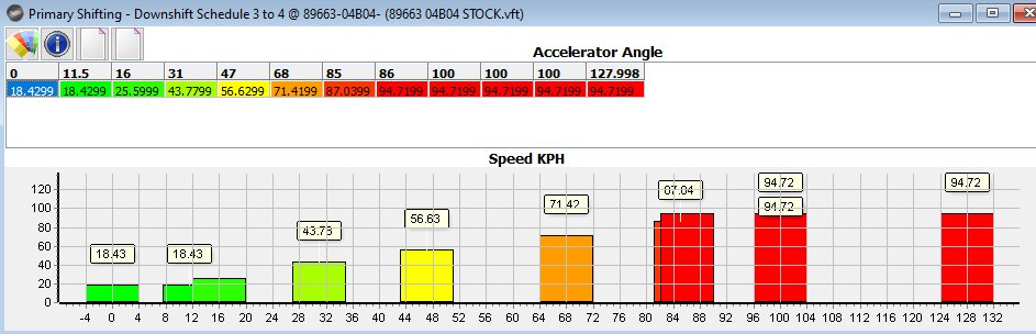

    The primary shift maps for ECUs 04B04 and 04A61 stock files are identical, so I doubt it is just 04A61. It would be easy enough for someone on other ECUs to log and prove out.
    But let's do a thought experiment. The screenshot below is the stock 3-4 downshift schedule. If the units are kph, one can calculate that at 11.5% accelerator position, the truck will not downshift from 4th gear to 3rd gear until the engine rpms drop to 485rpm. That's below idle speed. I'm not buying that. If the units are mph, then the rpms need only drop to 780 rpm. Still crazy low, and a big part of why the stock tune sucks, but at least a more believable number.
