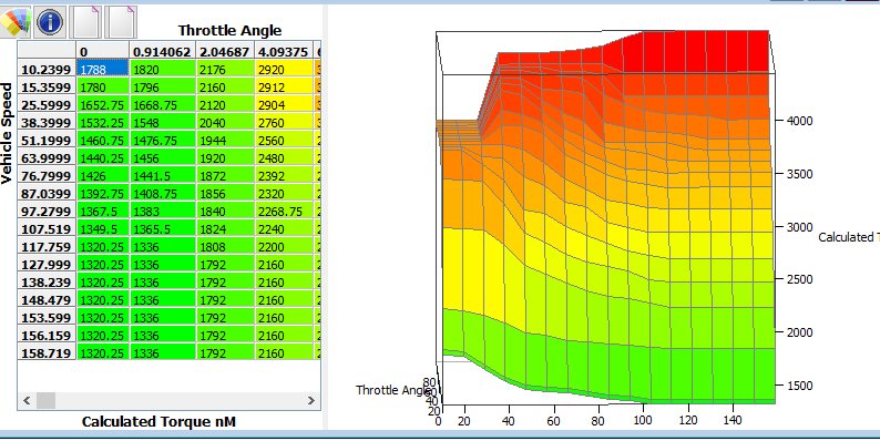

    A little something like this?
    Been playing with this a little. Will adjust as needed. Using this on 2-12 and 14-17. Not sure what they’re called in 1.2.9.9.8.7.6.3 or whatever the latest release is...

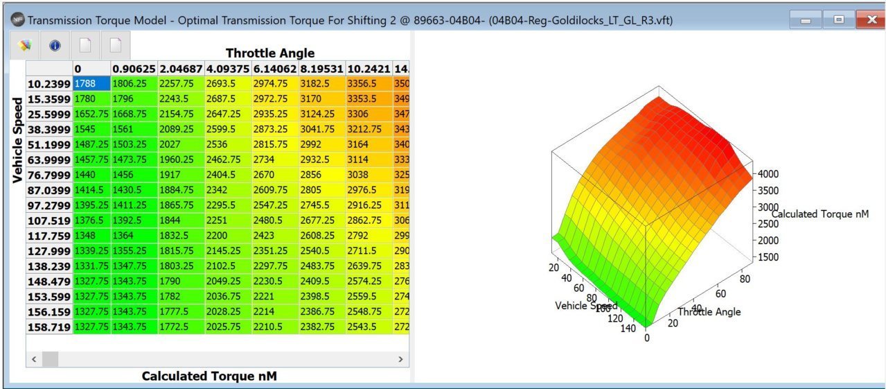

    here is my few cents. When OVtune shared a sample file with these maps, I plugged them to all tables, except S and reverse. Back then I was chasing 4-5 hanging upshift. That change did not help with the issue. Also notice changes to shifting 2-3-4 on cold engine. It was not rough all the time , but enough to tick you off. Other than that, there were no issues with driving.
    Once i figured that that 4-5 upshift issue is working in S , I started looking at the differences. It seems S table has lower #'s in 20-40 throttle range and given speed. Now I know that there is Warm Engine table and tempting to lower numbers for 90+ speeds. But waiting on the correction to this statement:
    "....Torque calculation > Optimal torque = Downshift
    Torque calculation < optimal torque = downshift
    Torque calculation = optimal torque (within a %) = optimal = no shift..."
    Yesterday I plugged Warm table (old table 3) to all, except S and other 2. I noticed that shifting is somewhat better on cold engine . I only had one 4-5 upshift situation and it did work. However, my speed was just above 60 . Need to do more testing to confirm.
    Table 3 -Warm
    Table S

    That shout be a solid base. Remember to monitor throttle, not accelerator when fine tuning this.

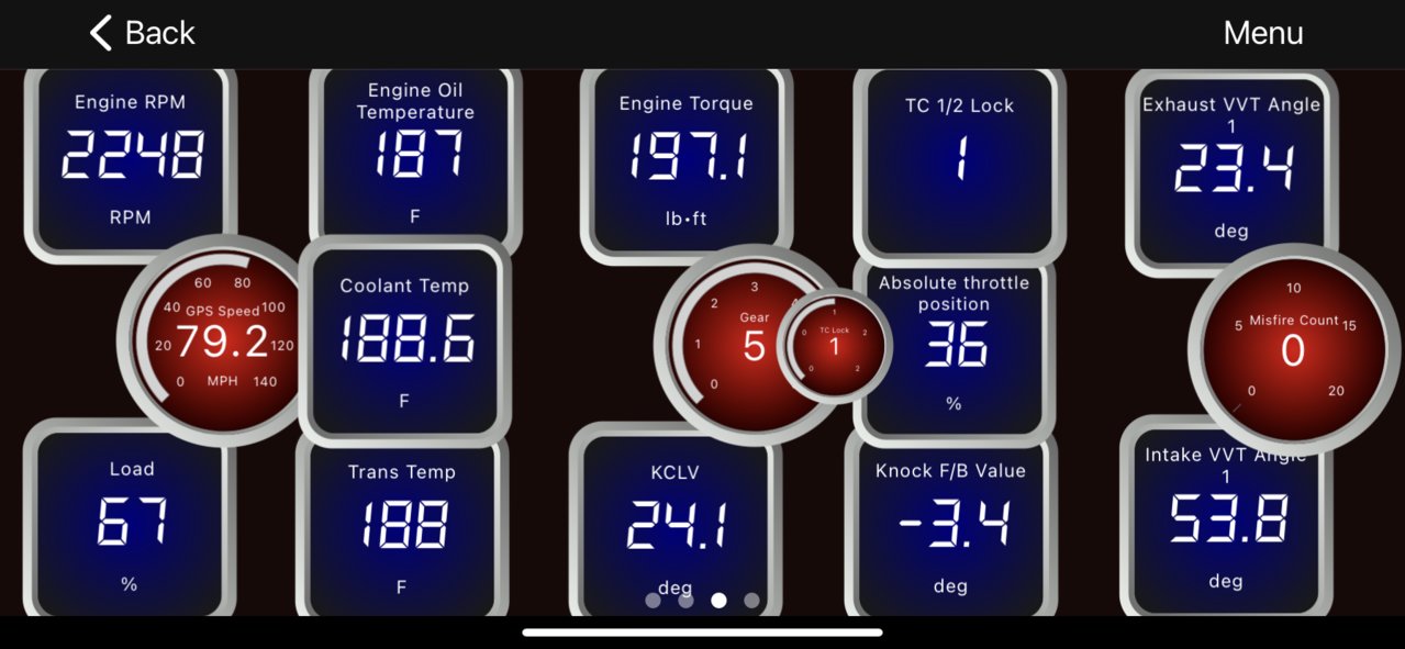

    Yeah, I’m using Fusion with absolute throttle position for monitoring.

    It is a generic PID and references throttle motor duty ratio. Not sure if this correct PID to tight to Vf values.
    Here is a comparison of that PID to Toyota's throttle related PIDs.

    I’m not super original, I’m using @PapaRee dashboard. So far the correlations have been good enough to make adjustments that seem to work out.
