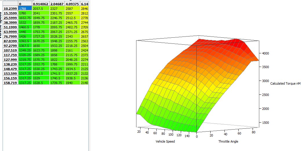

    Yeah I’ve done the copy and paste Warm 1 map to all except those few. Shifts good, I just had some time to mess around with the map more. Just wasn’t sure exactly which areas to mess with the most.

    25-65 mph. 5-30 throttle
    Ish... Where you spend most of your time driving and feel the need for improvements. Change those.

    Appreciate it! I'm going to start with something like this and adjust it from there.

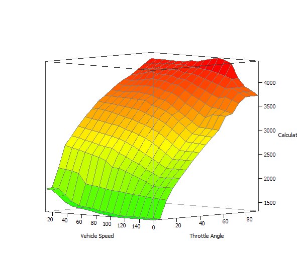

    Smooth out the peaks and valleys. Rolling variances are ok.

    You talking about the ones to the far right of the map?

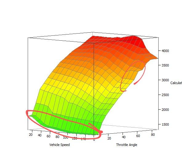

    I got the top right one smoothed out, as far as the weird area at the bottom. Am i wanting that to be a smooth transition or keep some sort of a "flat" area like the map has?

    Smooth out the big dips. That area isn't really critical, but it seemed to help. Control-I first row to third row to rid of second rows huge dip

    Am I going the right direction? :goingcrazy:

    Absolutely, now give it a rip. Monitor throttle position and speed. Adjust accordingly. Raise the areas it shifts "rough". 2-5% +/- at a time.
