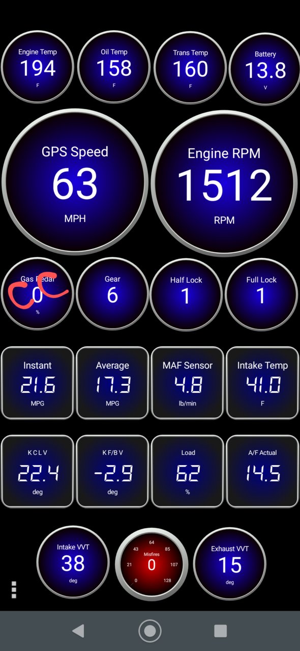

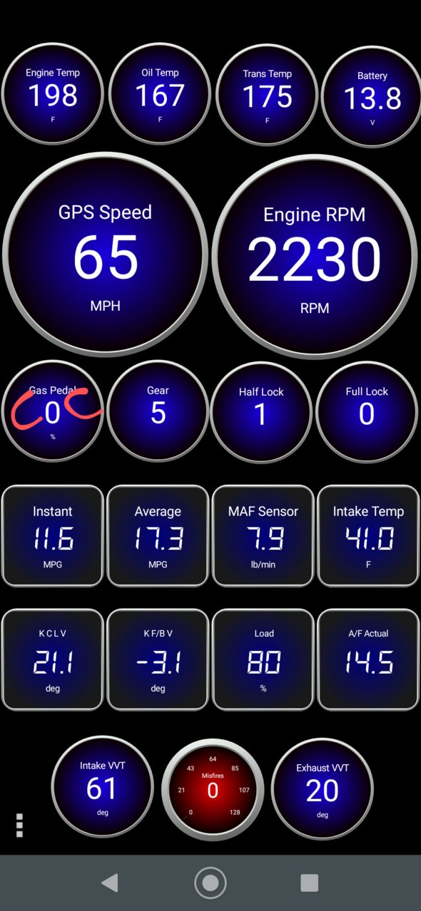

    On the hwy with Cruise Control!
    And a proper downshift ascending a hill, with Cruise Control!
    PRO_Taco and uploadadventure[OP] like this.

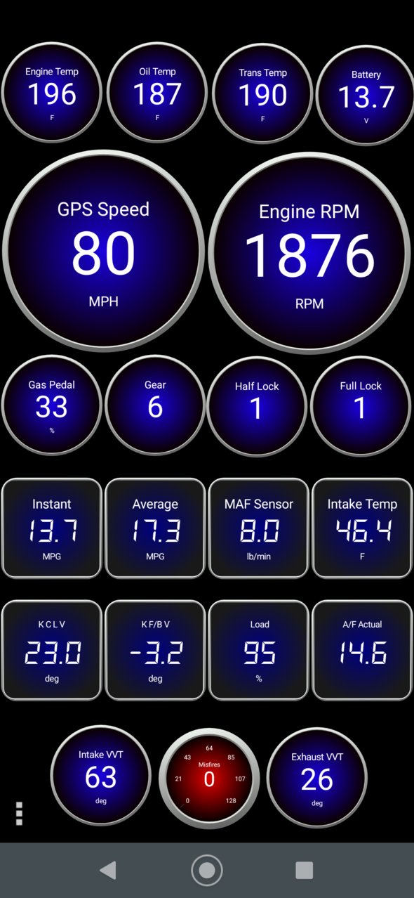

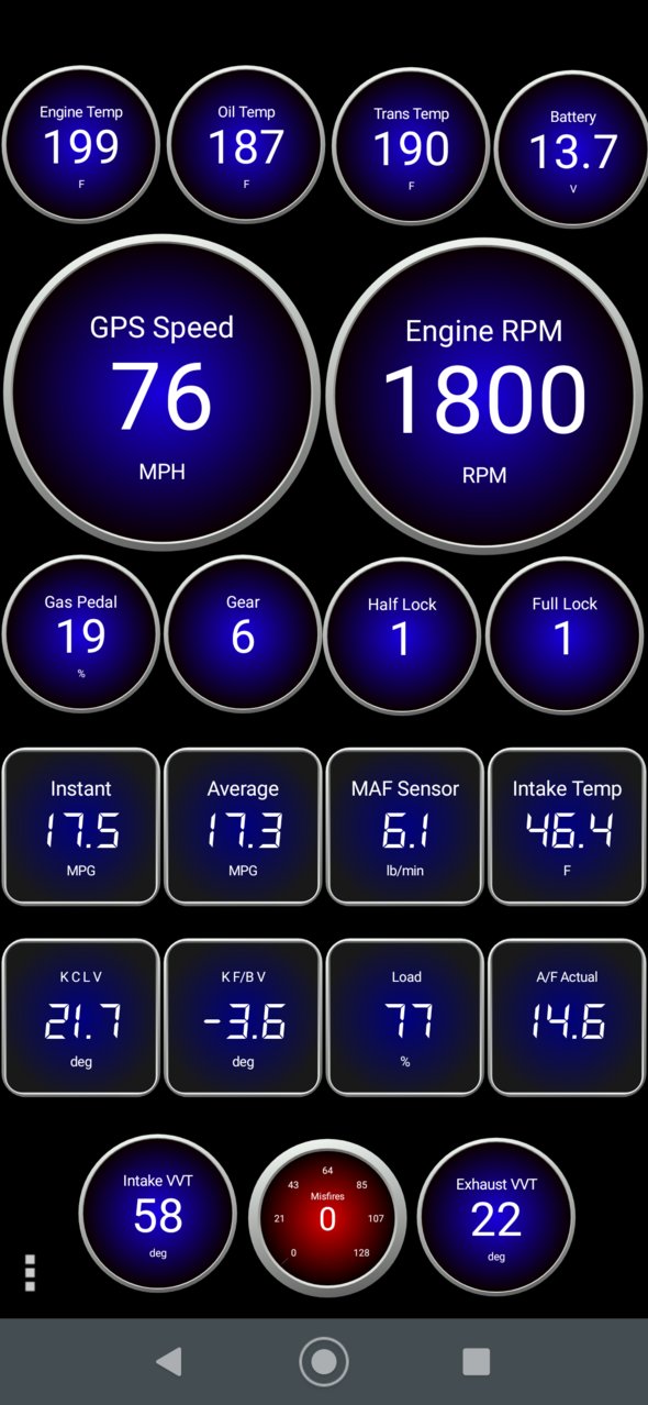

    Cruising the interstate
    Gaining speed while still holding onto 6th.

    2017 trd Tacoma offraod AT Inferno
    315/75/16, 6in modded RC lift,Anderson Engineering manifold spacer,K&N air intake, URD YPipe, stock exhaust ,16" method nv305 wheels, AFE throttle body spacer, vf Tune program, JTL 3.0 Oil catch can x2, rear cat delete
    I've been monitoring with the app and I'm getting same load % at those speeds
    Mooseditty17 likes this.
