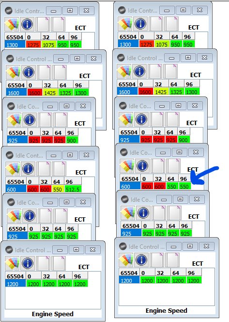

    This is stock settings on the left and your settings on the right. I saved your file before sending it to you...
    I'm not sure what it is that you're having issues with, but idle settings should not be the culprit.
    I will have to double check if the one I posted on TW for 04B04 was this way or had the changes @TermLimits is referring to. I personally am running the settings @TermLimits suggested without issue.

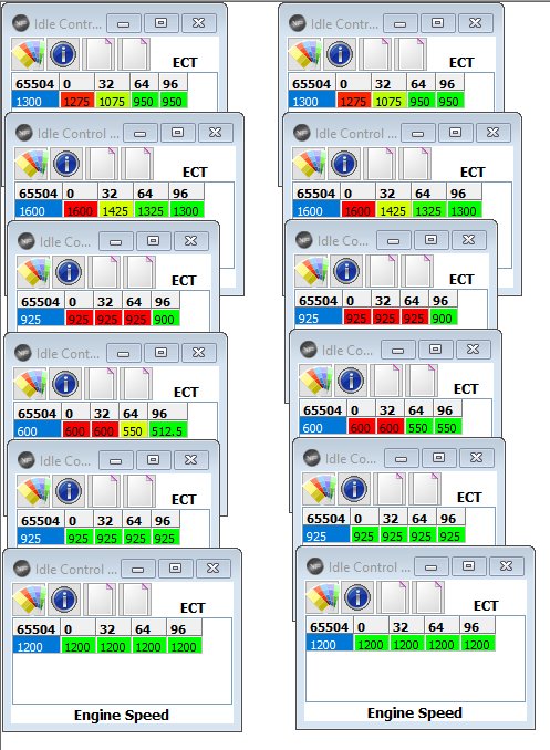

    The version I shared on the thread is the same. only change was to the 512 at the lowest part of hot start idle. Changed to 550. If that is indeed the possible culprit, I will change this for all to reflash if need be.

    I did more tests this morning. It’s the AC compressor. With stock idles so high when the compressor activates it does not make a noticeable change to the idle.
    Reduced idle speeds: you can sit in silence and listen to the truck. You’ll hear the compressor click active from inside the cab, the idle will bump up then reduce shortly thereafter when the compressor disengages.
    In park it was most noticeable on my tune not sure about Moose’s.
    @Mooseditty17 unfortunately I don’t have a suggestion for what ranges to bring them into to reduce the compressor spiking. To me, this is normal since most of my other vehicles do this just maybe not as pronounced.
    Ultimately the city mpg increase is worth it to me, maybe raising it 100-150 on the hot and warm will make it more subtle
