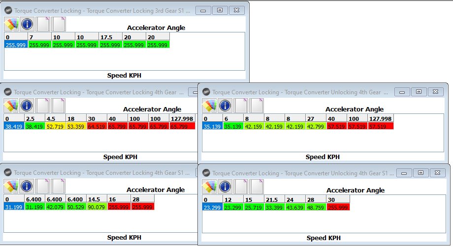

    OK. Here is a vid of a full throttle pull. 1st through 3rd gear only.
    https://photos.app.goo.gl/gXaYTrnJvL9oea6i6
    Trans temps hit 215* on this pull. After letting off the throttle I came back down to 185-190*
    Average temp on a 2 hour variable speed trip was 188 ish. My settings are attached in the screen shot below and the description and video were the results of these settings. I cannot get third to react to changes as I can 4th. I DO NOT UNDERSTAND WHY! No matter how low I make the unlock values, it bounces in and out of lock and it drives me insane! So I did what any red blooded man would do. I ELIMINATED IT!
    :infantry:
    Everything set the way you see here has been performing very well for me. My truck is a 2017. Lifted 3" with 33s and stock gearing. It weighs in, as it's driven daily, at 5200 pounds with me in it. I have yet to log ANY temps while towing. Before or after TC adjustments. That journey will take place in spring. Hope this helps point some of you in the right direction. Take note: the axis values of some or all tables are NOT what comes on the 04B04 map. I make all the S maps the same for lock and all the S maps the same for unlock. I also make 4th gear 1-4 all the same and leave the 5th and 6th map as is.

    I noticed your axis values differ only by a few tenths, I think just in the throttle limit tables. Assuming that really doesn't affect much.

    If that's all, it'll be fine.
