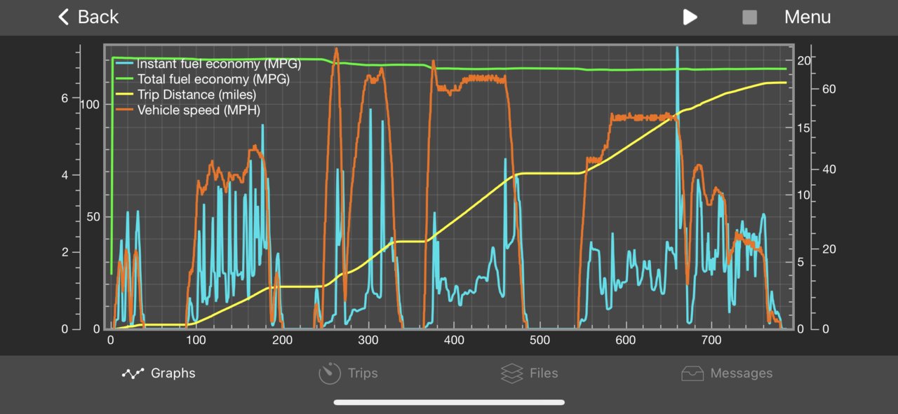

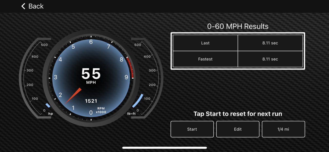

    Lol I did have someone mention to me a day or two ago that I could just do Uber or doordash to fund my time tuning and test at the same time. It was nice to have a suggestion of getting a second job on top of time invested in tuning.
    Here is an slight uphill 0-60. If I can deliver in 30min or less Kreg should be able to in 5min:

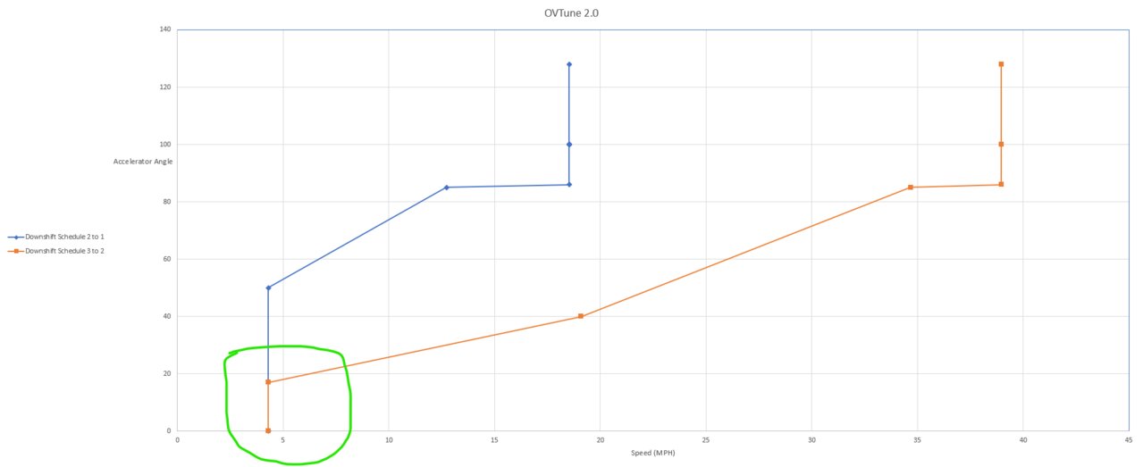

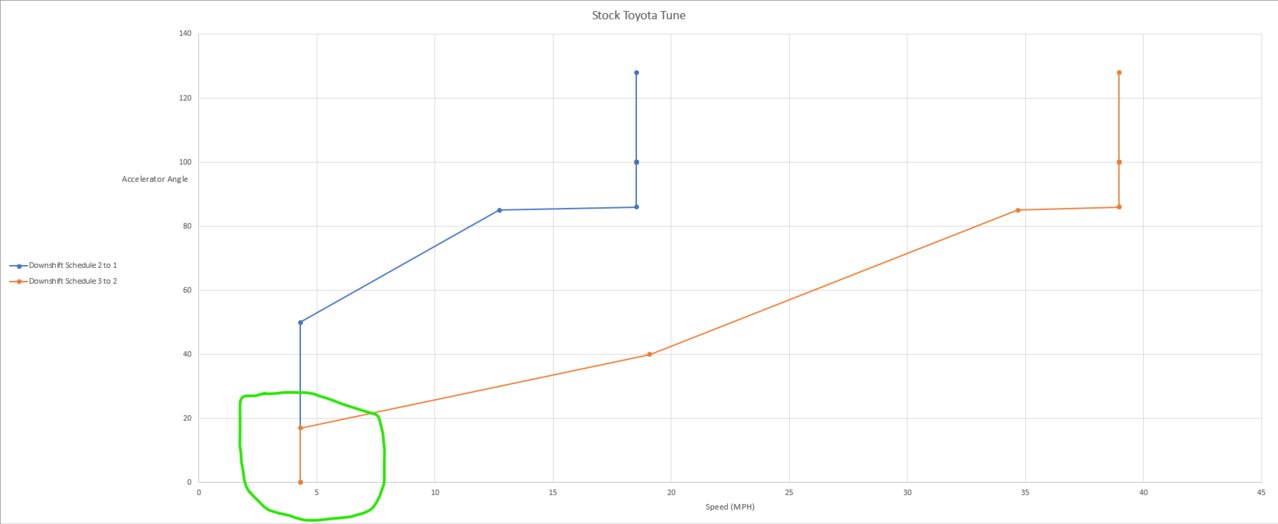

    The clunk was an easy fix for me, as I had it when coming to a complete stop. I actually talked with @PapaRee and @Mooseditty17 about it. There were a few tunes where downshift points were adjusted. I graphed out stock, 2.0, and the tune I was running at the time and easily saw the differences. Stock and 2.0 have the beginning of 3 to 2 downshift matching that of 2 to 1 downshift, whereas the tune I was running had a gap.
    Stock Toyota Downshift:
    2.0 Downshift:
    Unnamed Tune Downshift:
    Adjusted values to match stock/2.0 and voila! Clunk gone when coming to a complete stop.

    Code Brown driving mpg test performed. Successful I’d say
