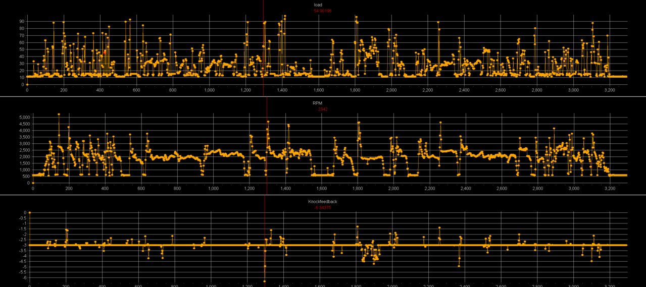

    I'll follow this up with the fact that i put 12 revisions into fine tuning this on my truck. Running 89 on an 87 file. Logging the load and rpm range where i would see knock feedback go all the way to -7 for extended times
    Now I'm only seeing some areas are -5 in less than 2k rpm and loads of 40 and 80%
    All other ranges are between -4 and 1.8
    my knock learned value would be 16 one day and 21 the next.
    I'm now staying between 23 and 25 depending on air temp (50 degrees i get 25 and 70 degrees i get 23)
    I think i have room to improve slightly once i knock out those other ranges.
    I'm adjusting in 1 or .5 increments
    This one thing helped my truck be the smoothest it ever has especially during acceleration.
    The big issue is that for the most part, this could be vehicle specific and fuel quality specific.
    PapaRee[QUOTED] likes this.

    2019 Cavalry Blue DC TRD OR 6MT
    For reference this was my drive earlier today
    PapaRee likes this.

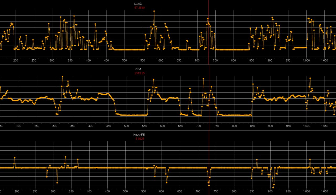

    What tables did you modify to reduce knock feedback?
  10. Mar 29, 2021 at 4:00 PM
    #3090
    92ehatch
    92ehatch Well-Known Member
    Jun 9, 2019
    #295818
    841
    Kinley
    Hendersonville NC
    Low knock direct
    Low knock port
    Here is one of my earlier log files (unfortunately i dont have the earliest files with the worst, i didnt know how to do the logging, i was adjusting based on the live data)
    dunlap837[QUOTED] likes this.
