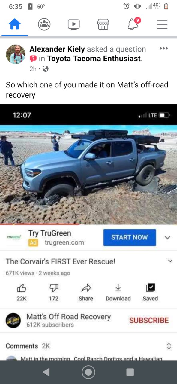

  8. Apr 28, 2021 at 4:43 PM
    #3148
    TermLimits
    TermLimits Owner of Valley Tuning
    Feb 5, 2021
    #355189
    514
    Jeff
    Cleveland, Ohio
    2016 QuickSand Tacoma TRD OR
    ValleyTune.com Current Tunes: Valley Runner
    Does look a bit like Rich's truck.... Tanks are heavy ya know

  9. Apr 28, 2021 at 4:45 PM
    #3149
    Mooseditty17
    Mooseditty17 Seasoned Rookie
    Apr 7, 2019
    #289395
    1,681
    AJ
    WI
    2017 TRD OR : M+W Nexus Tuned
    Tune: Nexus +P Add ons: +3" custom suspension 295/70/18 Yokohama M/T Tires KMC XD Grenade OR wheels KN intake Blackhawk MBRP Exhaust TJM Rock Crawler Bumper Lighting (+10 H.P.)
    Pigs like to wallow in the mud :D
