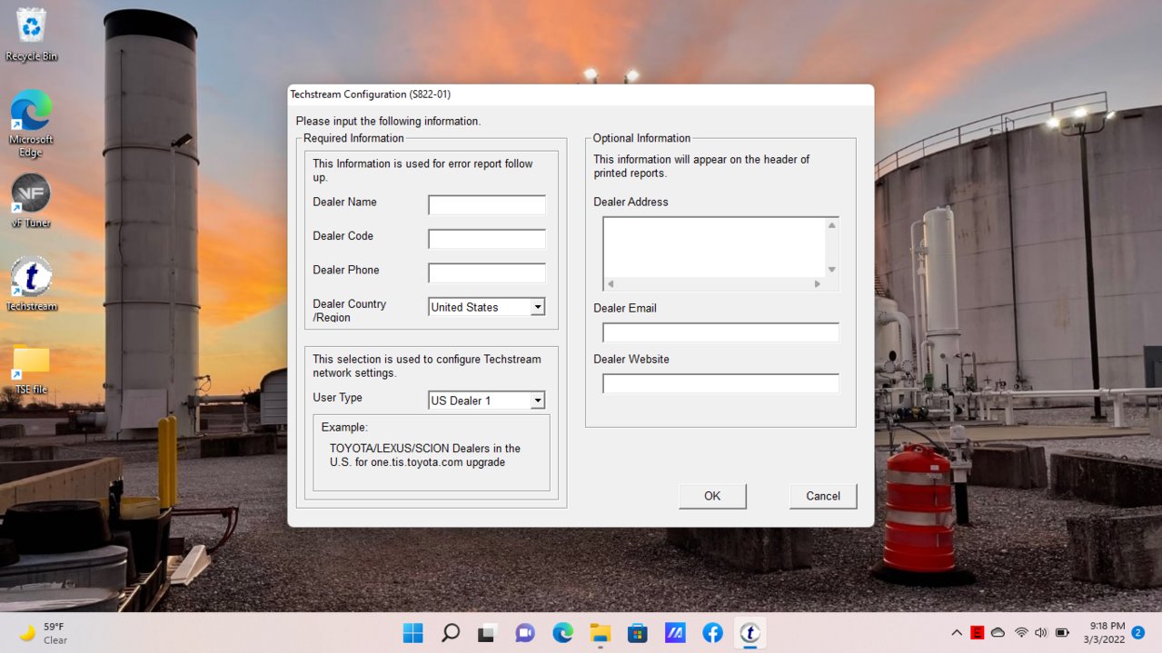

    I'm hung up
  20. Mar 3, 2022 at 7:25 PM
    #3340
    mZiggy
    mZiggy Honey badger
    Apr 8, 2017
    #215707
    4,709
    Marc
    2020 MGM Tundra SR5; 2020 4R TRD Pro; 2008 4R SR5 v8
    Put ABC for that shit, or some other junk lol
