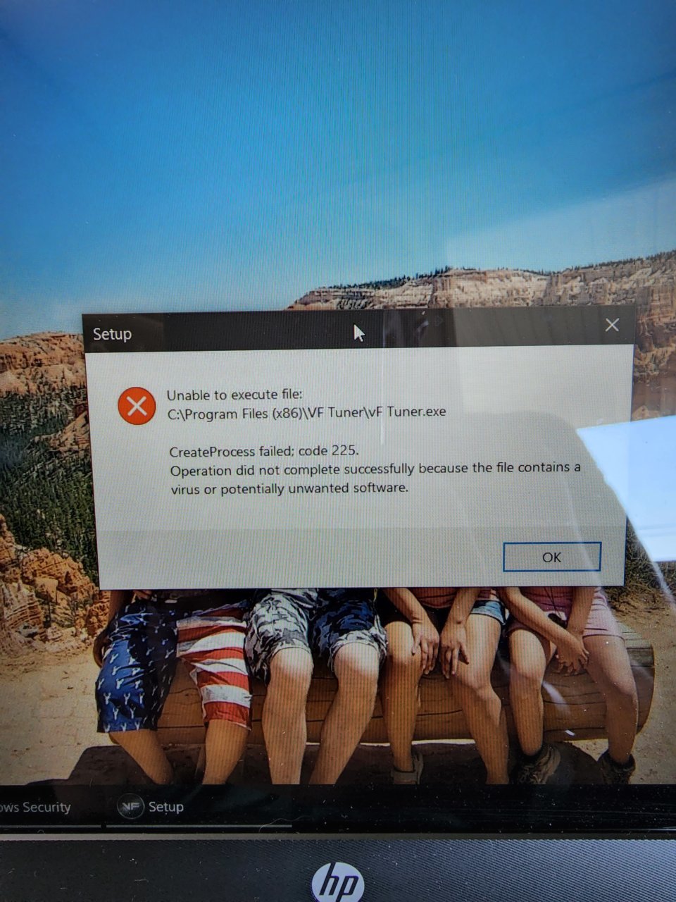

    So I updated vf tuner today and having issues accessing tuning program now.

    #3411

    Vf has been working great till it updated today.

    When in doubt, fully uninstall and reinstall

    That looks like your antivirus software kicking in. You’ll need to tell the Nannie’s that it’s okay.

    Well I ended up reinstalling the previous version and had successful reflash so I'm good to go
