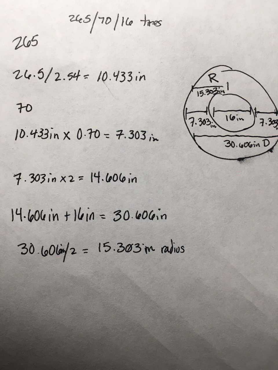

    Ok did you put down 15.303 (value based on 265/70R16) for in radius? That's the one change I made from the stock default value (15.499). Yea I believe its at NOB but I'm at Portsmouth shipyard. The Enterprise is out at Newport News. Pic for illustration.

    No, I left as is. I don't consider it much of a big deal, to be honest, could update it in the future if necessary though.
