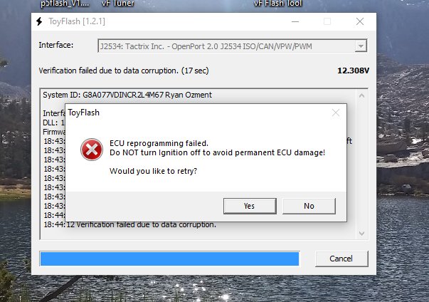

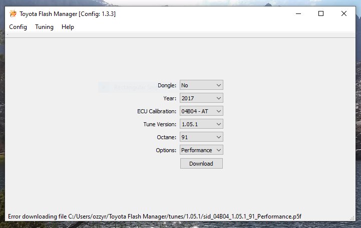

    Well guys i think i did it. went out to my truck to install tunes and these pop ups came up. now the truck wont start, i even tried going back to stock and same message. am i doomed? lol any help would be appreciated before i have to send it over to the dealer. it wont even let me identify the truck.ECU.jpg OVTune.jpg

    Are you trying to flash a .vft in flashmanager?

    Did you know your ECU before flashing?

    Looks like he is trying to flash 105.1

    That won't even download anymore. I have the feeling he trying to flash one of these tunes in this forum. If you try and flash a .vft in the original flash manager you get that same error.
    He needs to use a .p5f files. If he tells us which ECU he has, we can help him.

    At first i was trying to use flash manager to get 105.1 but could not get it to download. SO i then went thru vft and used p5flash with some tunes from this thread and got success with everything up until this pop up. i have the 04B04 ECU.

    The screenshot shows @keepitwild was trying to flash 04B04

    Do you have the 04B04 stock tune? Try to reflash back to stock. Make sure all your lights and radio and screen are off.
