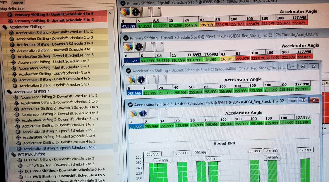

    Has anybody changed the Acceleration shifting tables to match your primary shift table? I was comparing upshift tables from stock tune to my tune and ran across this.

    @Mooseditty17 has messed around with those tables... He may still be tweaking them.

    I did. Not really sure if it did anything or not. Moose discovered they control 4 low. No one has confirmed whether they affect anything else. They may be misnamed.

    I copied the values for 4th gear into 5th gear upshift and downshifts and raised the values by 10. I now have 5th gear in low 4. The problem is something is limiting throttle at 57 mph. 4th gear 6000 rpm. 5th gear 4200 rpm. Both cut out at 57 mph.

    I had a frustrating four week vacation with unedited 2.0 driving from Houston to North Dakota, Idaho, Arizona and back. I can't say I ever experienced an egregious fourth gear hang. I keep a ScanGauge hooked up and when I monitor load, it does not appear to have a significant hang. I think it's perception. I think I've crested the hill; but, the load reading says otherwise. I think I'm on flat ground; but, the load reading says otherwise. Etc. It seemed to always shift by ~40 load which then gives a pretty high load in 5th. (My primary frustration was with the huge power gaps between gears/shifts... I have since fixed that.)
    Maybe the slight hang is fixed by the "Optimal Transmission Torque For Shifting 10" change? Maybe in those 'hang' situations CC is using those maps? I believe the only shift map changes in 2.0 are in the "#1" set. Apparently, pressing the accelerator while in CC triggers a different logic; perhaps, from the OTTFS10 map (or primary 6/8) back to the #1 maps?

    Yeah I've matched the transmission shift map 6 and 10 to my primary shift maps and will give that a try. As far as the hang you're probably correct if it's in those maps. Appears to shifts better with cruse off.
