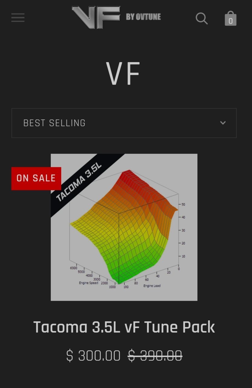

    Good luck! You have a good resource with @ktbell444.

    How'd you find 04B50 only 04B31 and 04B33 have existed for 2019 automatics.

    Just happened to get an odd one. You'll see it every once in a while.

    Sucks though, I don't understand the changes. I get the differences in ECU memory size (1.5MB vs 2MB) requiring a different ECU ID, but each year being different seems odd to me. Then on top of that you throw in an uncommon one.

    Mat from VF Tune sent it to me

    I bought my trd sport in mexico. That probably is why the ECU is odd..
