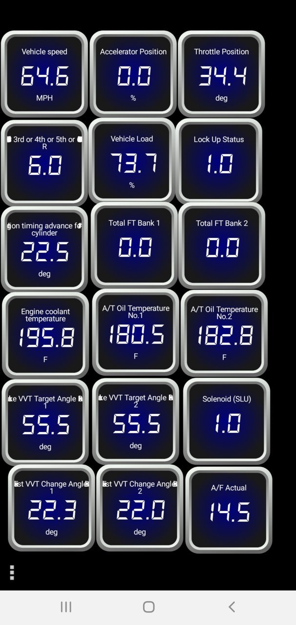

    On flat and small inclines the tune is Awesome, held 65MPH in 6th never dropping. I like @Vlady am in a mountainous area here is some data on my first 20 mile warmup flat/small incline.

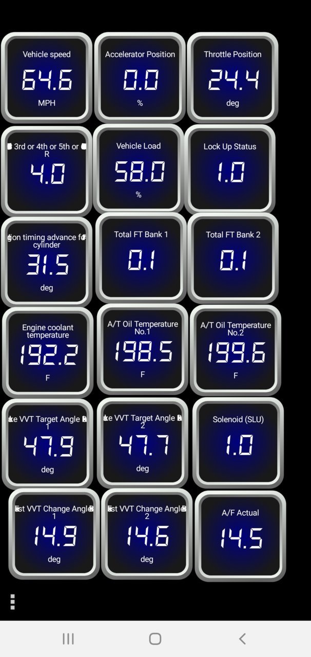

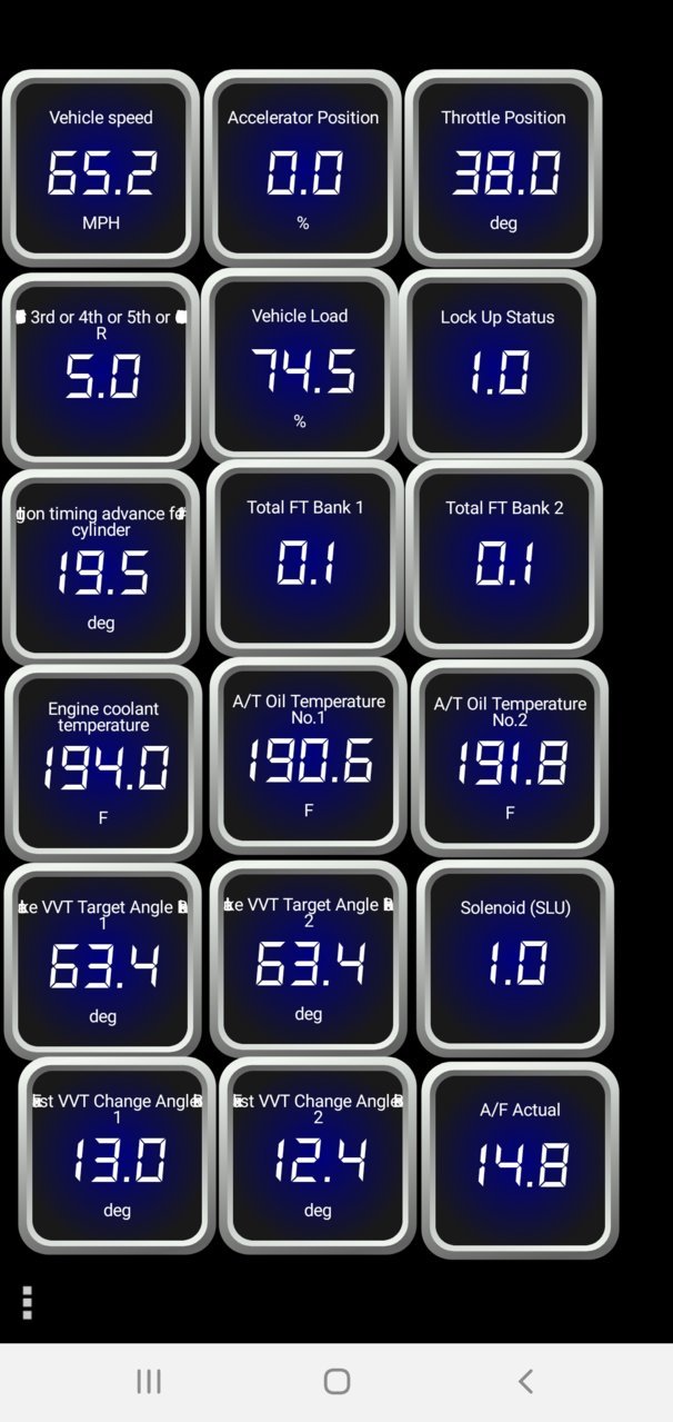

    Mountainous numbers: First drop to 5th. Then 5-4 and stayed there...steep long incline.Screenshot_20210102-154059.jpg Screenshot_20210102-154552.jpg
