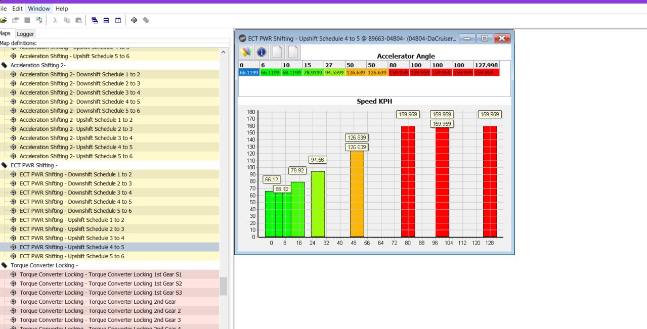

    I'd like to adjust a shift from 4th to 5th WHEN ECT is enabled to shift a little sooner. I was trying to find the notes about not just adjusting the shift point but perhaps (even alternatively) the torque table for it. Can anyone shed a little more explanation to what I should try out based on the current knowledge....just not 'getting it and no webinars/training videos yet). Thanks TW!
    Edits:
    I was going to just lower the primary shift tables for upshift 4to5. Just not sure if I need to be mindful of the primary vs ECT PWR Shifting vs accel shift tables then the torque tables

    Easiest way is use this table. It is specifically for ECT shifting.

    If you want to modify ECT shifting, you need to modify the ECT shifting schedule.

    Yeah, seems easy enough, thank you. I'll give it a shot tonight!
