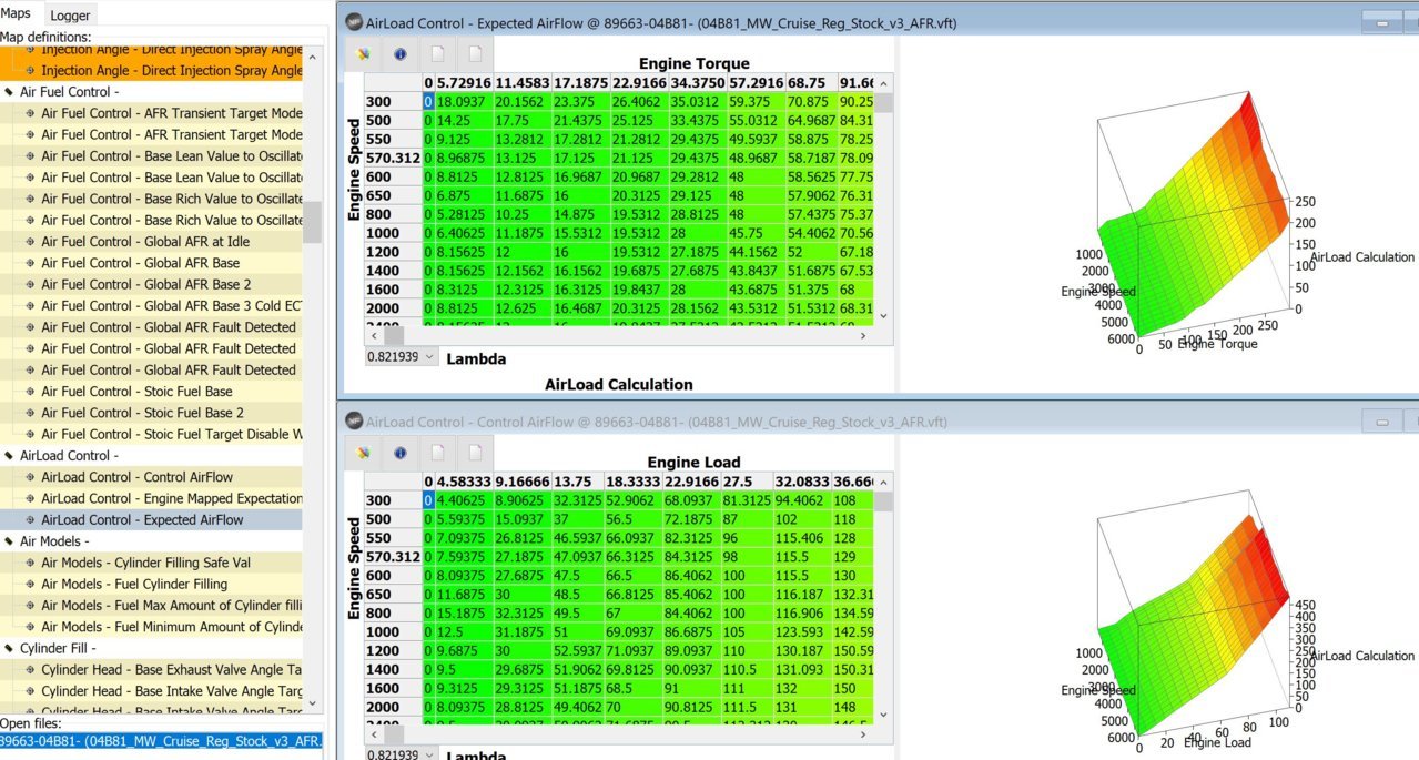

    Can you detail the AFR changes (what tables)? Or a post? I implemented your cruise settings on the tune I'm running (m&w a bit aggressive for me). I'd like to try the AFR changes. Thank You

    Lambda 0.99 and 0.82 tables are now matching - Air Load Control Tables

    Based on @Mooseditty17's findings and suggestion (we talked about in the other thread), I used the lambda .99 from 2.0 for both .99 and .82 on those 2 air load control maps---control airflow and expected airflow.
