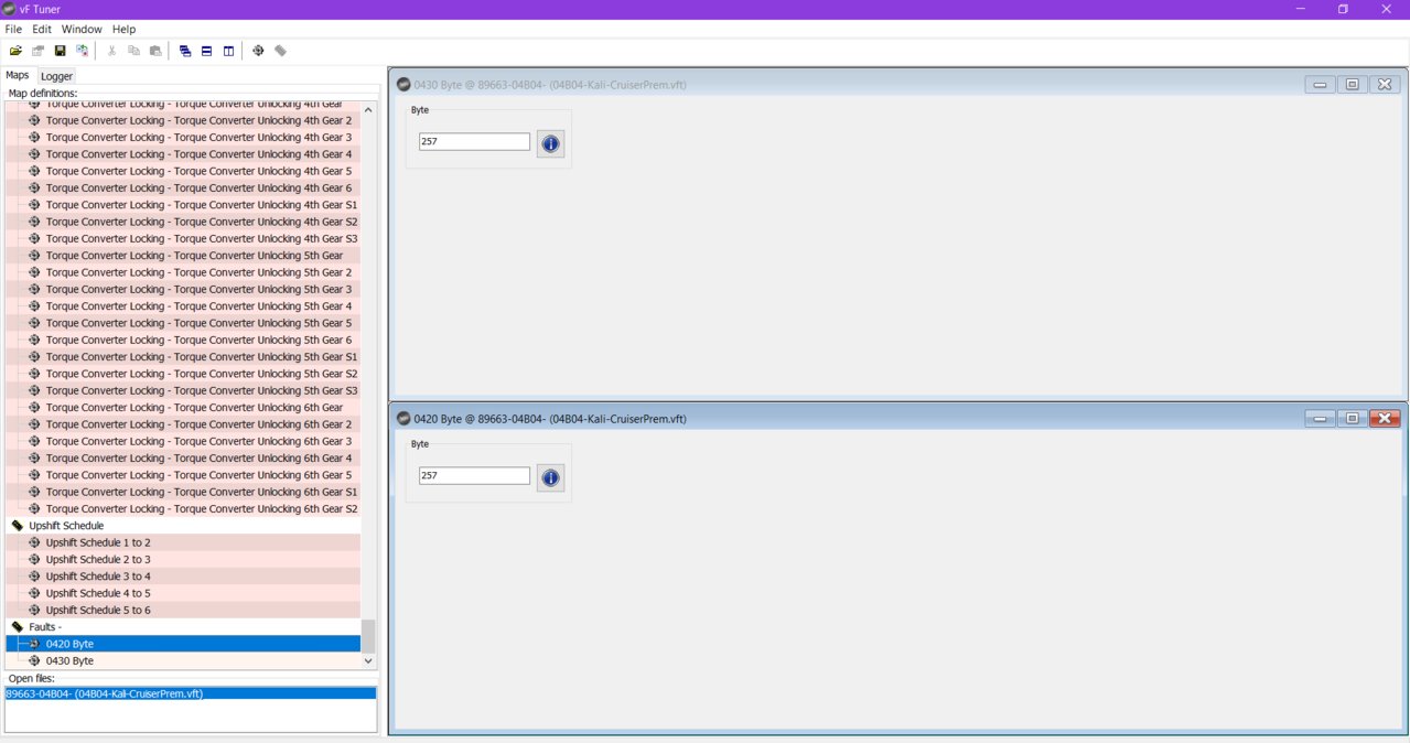

    Anyone had any luck with a tune that works with catless dump tubes? I had a tune made by @Mooseditty17 with dump tubes accounted for but I still get a CEL. I thought I remembered reading on here somewhere that it was the same fix for catted as catless dump tubes.
    Any info appreciated!

    From what I remember, you have to change the values in the last two maps in VFtuner to 0 (zero).

    That's what I tried... Worked for a guy with catted dump tubes, but not the catless
