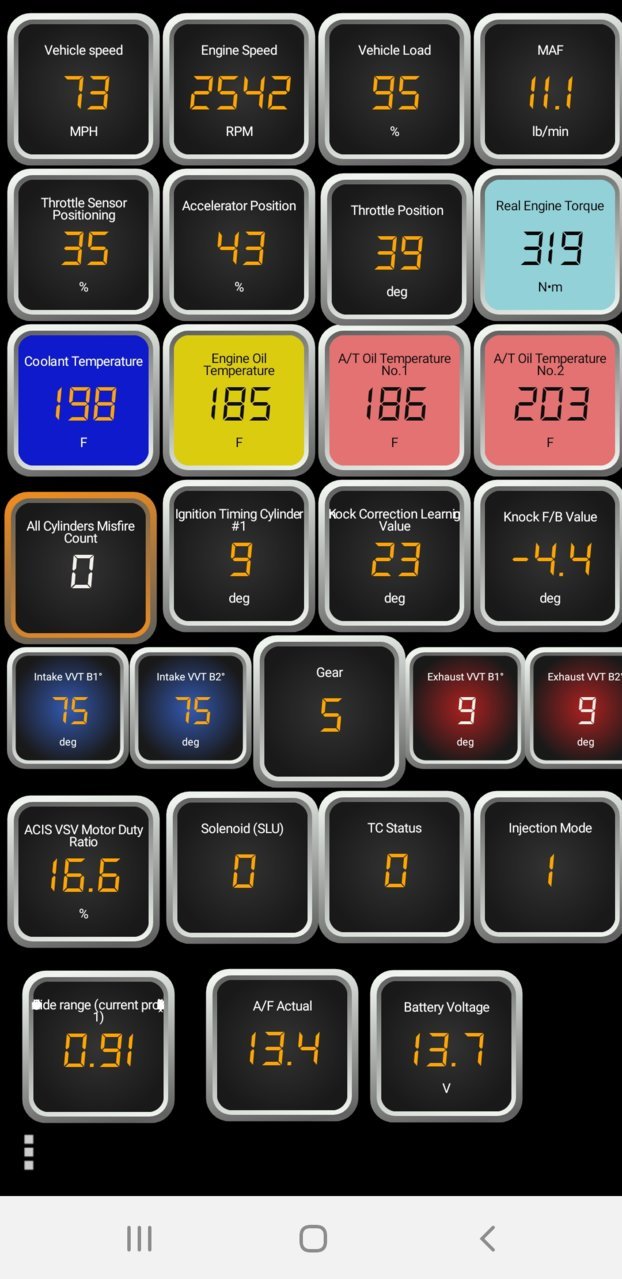

    If I hold longer at these conditions below, the TC temp is climbing really fast. The pan temperature is steady.
    Once I hit TC temp 220°for a few seconds.
    If I back out of the accelerator a bit, SLU solenoids is turning On and TC temp is starting going down.
