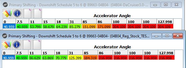

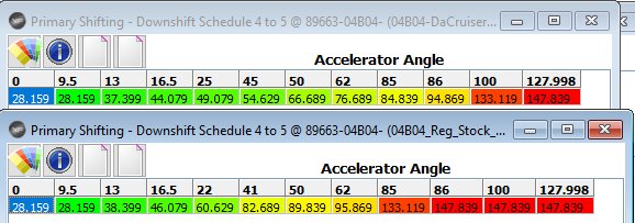

    Vlady
    Vlady Well-Known Member
    Dec 20, 2017
    #238986
    4,445
    Issy, WA
    2017 White SR5 DCSB V6 4x4
    yes, those shift point are way to the left and you are hitting Max allowed load. My table is the bottom for 5 to 6 downshift. Speeds in high angles need to go to the right for early downshift and maintaining the momentum. I yet to see downshift to 3rd on my hills
    5 to 4
