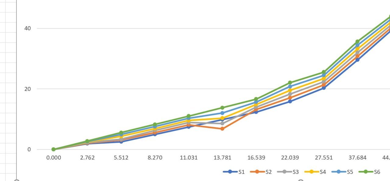

    Here are my values for Throttle Limits S gear 1-6

    What values are you using for the accelerator angle for each gear? Are you using the same values from the 2.0 or ??? Would you be willing to share your primary shifting US and DS tables?
    Edit to clarify, I'm tired and missed that the image of the excel table you posted was throttle not shift points... Nevermind...

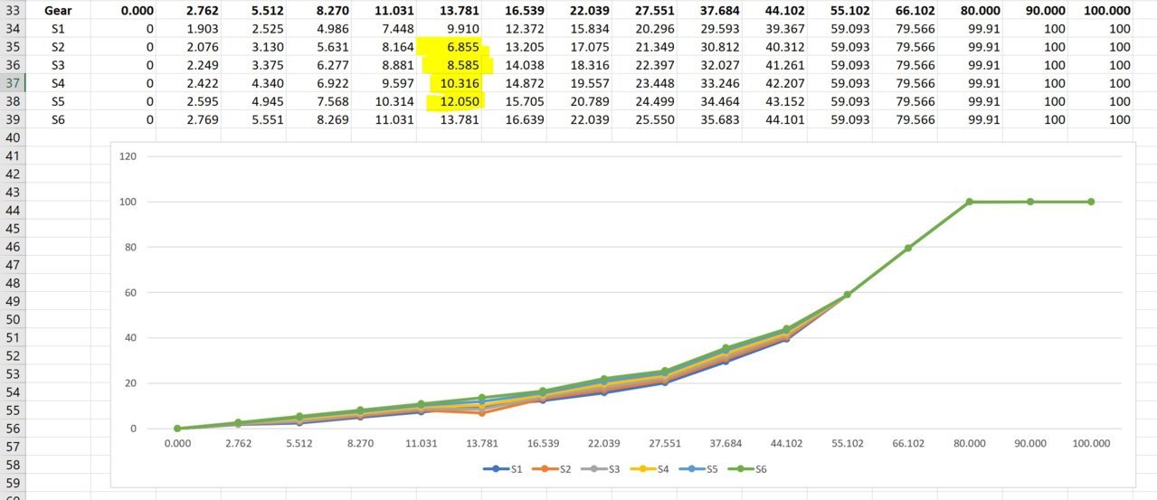

    Edit edit... Looks like you got an outlier there in S2, actually they all kind of deviate for S2, s3, S4 and S5 when you plot them. Is that intentional? Also, typing that into excel sucked, can you post the excel next time? :thumbsup:

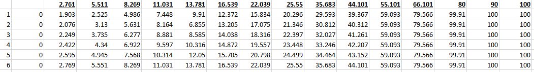

    Yeah, I copied it from my excel and it is not correct. Let me resend the numbers..

    attached
