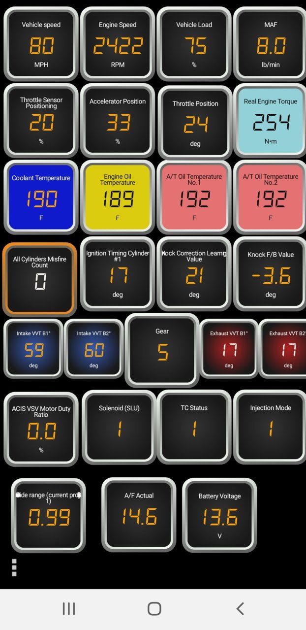

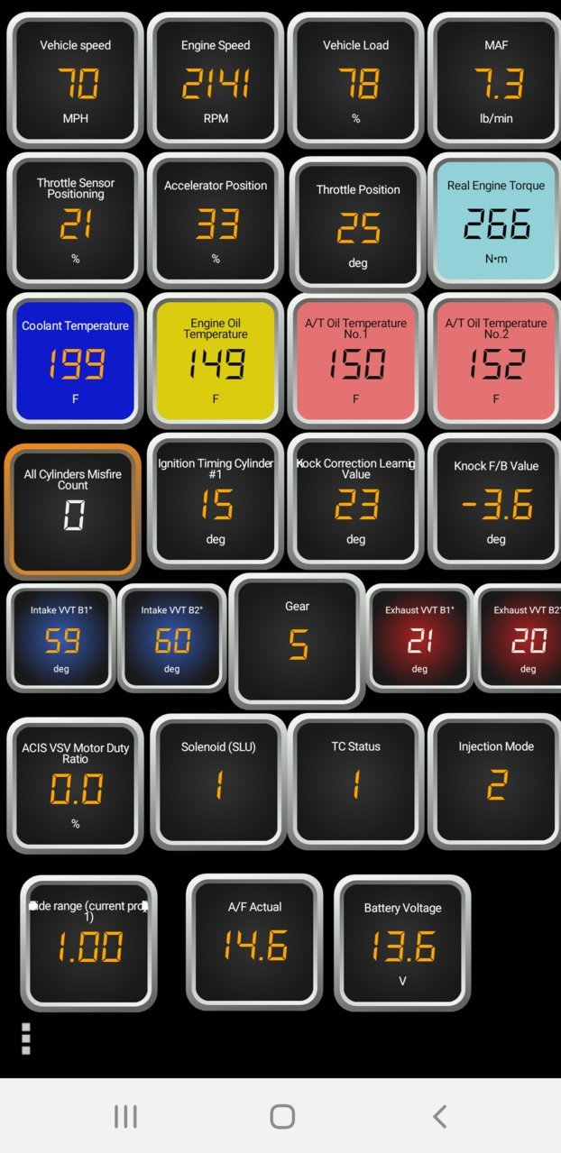

    Still needs more testing, but I think I figured tc unlocking without raising the temperature of the converter.
    Before, I was not able to spool more than 2200 rpms going uphill at 70 or above.
    Did some changes a while ago that allowed to bump rpms to 2500 at 34-36* angle, but I was not comfortable with the temp of the converter going up on long inclines. (SLU=0, TC Lock=0)
    After reviewing a bunch of TS logs, I decided to update TC Unlocking 1-4, 5-6, S1-S3 tables for 26-40* range. I was surprised to see rpms going up to ~2500 while SLU and TC are locked. Also I was able to push the accel to 45* on the climb and got the acceleration without a kickdown to 4th. I was comfortably doing "the traffic flow" on 5 mile incline and the accelerator felt alive and responsive.
    (1st image vs 2 nd image with old TC unlocking)
    I still have no clue which tables control what, so I update all 3 groups. My goal is to have TC partially unlock between 70-75 while accel between 30-40, keeping SLU=1( converter temp is going down).
    5th gear unlocking 1-4
    5-6
    S1-S3
    Also I started getting consistent 4-5 upshift at speeds above 65 (67-70) under the load. Here is upshift 4-5 table. Still need to be revised for speeds above 70
    Still was not able to get the downshift to 4th working on my conditions. Actually I have not dropped to 4th on long inclines for quite long time due to 5th gear mods
