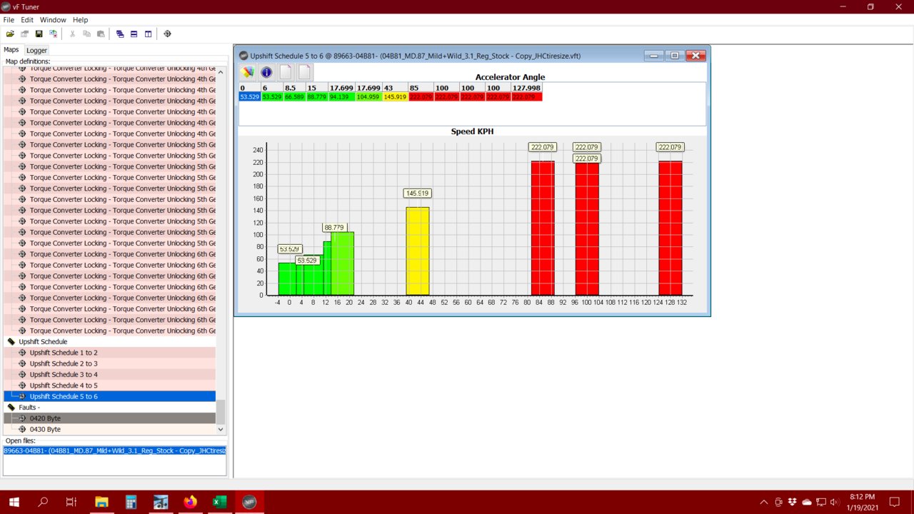

    upload_2021-1-19_20-12-9.jpg @Mooseditty17
    Thank you, Sir. Being a newbie, when you indicate putting the shift points to 255.999 for all values on five to six upshift, is this the correct table you're referring to to insert those changes? And, out of curiosity and wanting to learn, what does the value of 255.999 represent? What do the values currently in this table represent? Again, thanks for your help and assistance.

    That table will work. 256 represents speed in kph. Basically the truck can't reach that speed so it will never shift. All the numbers in bold represent your accelerator position. The non bold number represents speed in kph. Why are you not letting the truck use sixth gear?

    Primary upshift 5-6 is the map I use. The one you pictures should work as well. What @Chadr7858 is spot on. The gray values are degrees of accelerator angle and the values you changed are how fast the truck needs to go at that given angle before truck will upshift.
    @Chadr7858 he probably doesn't like trucks inability to really hold 6th gear. Mine doesn't do it well either. Even on a stock 2.0 map. Weight, tire size, and gearing are all against us for a second overdrive. Up to 65 my truck usually gets better mileage if I keep it in 5th. I live 45 minutes from the nearest interstate... So 6th for me, is dedicated mostly to 65+ Even then it doesn't like to hold gear as well as it should. When you make it hold, seems very bogged down and mileage suffers to the point 5th at higher rpm and lower load values are more efficient.

    @jc63 I hated 6th, mostly because it would require a double downshift to 4 at the slightest hint of resistance. I’ve got my minimum upshift speed set to 74 now. Works much better, downshifts to 5 if needed. No effect on mpg for me.
    PS the speed values are much closer to mph. They are definitely not kph.
    PPS this map is only one part of the shift equation. Engine torque and throttle position also play a role in ways I don’t yet understand. But you can do a lot with just this map.
