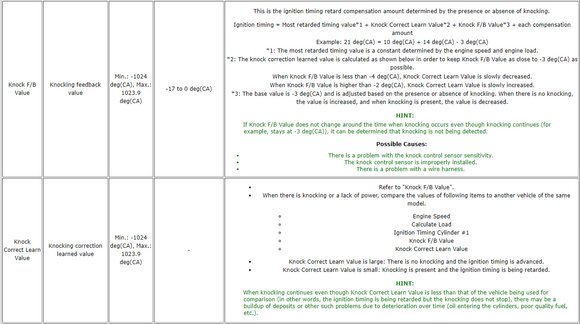

    https://forums.nasioc.com/forums/showthread.php?t=1008930
    Knock correction learned value
    Knock feedback value
    "Knock Correction F/B
    The number of degrees added or subtracted from the ignition timing based on the amount of knock detected. Positive values are ignition advance (due to the absence of knock). Negative values are ignition retard (due to the presence of knock). These ECUs run active knock correction, and it is quite normal to see -3 to + 12 degrees of correction."

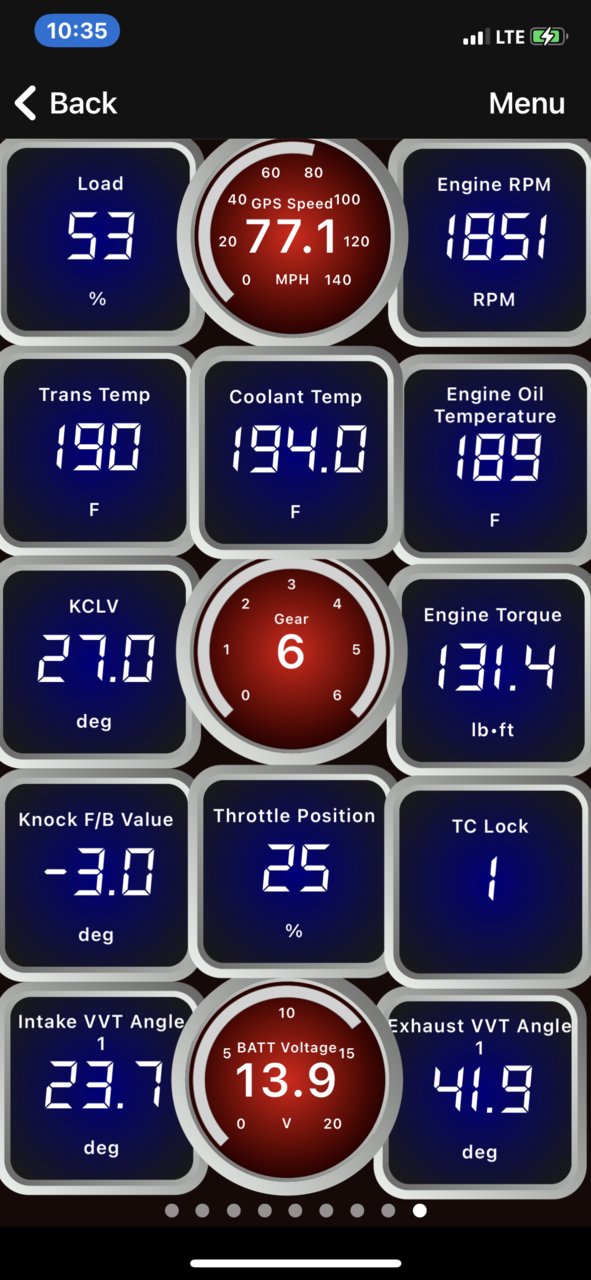

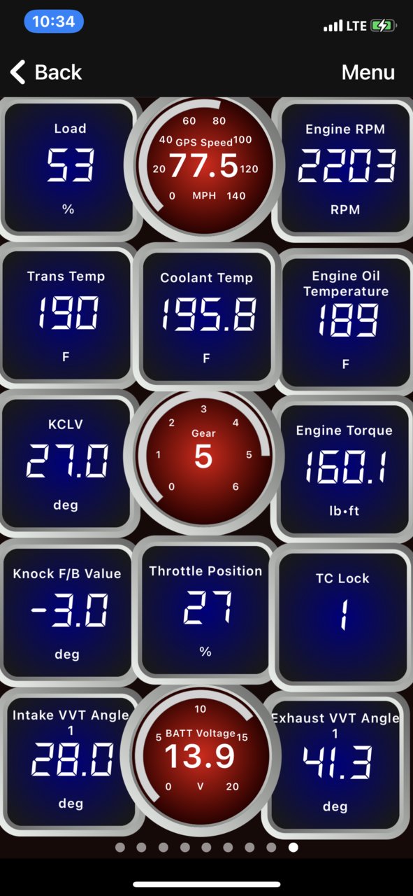

    On the highway today. Here’s my numbers. Flat highway with a few hills, no mountains in LA.
    73DD7E13-B96D-4706-9ED7-EF858A63400C.jpg E2B18BF8-9E9C-4B01-9051-43FCE98E52EE.jpg

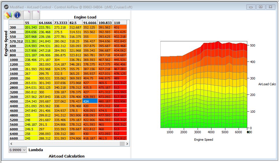

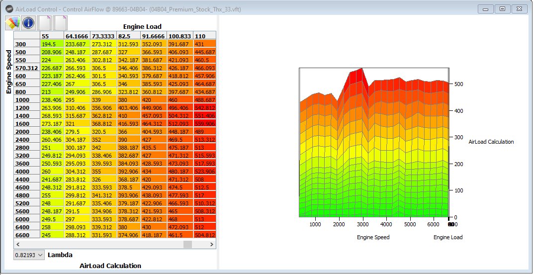

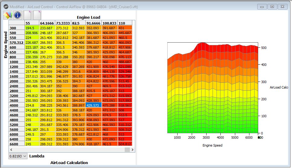

    Gonna give this a go on the Control Airflow map. Expected is very similar to Mat's suggested, slightly bias towards 2.0
