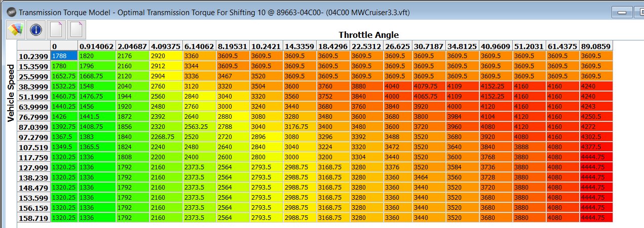

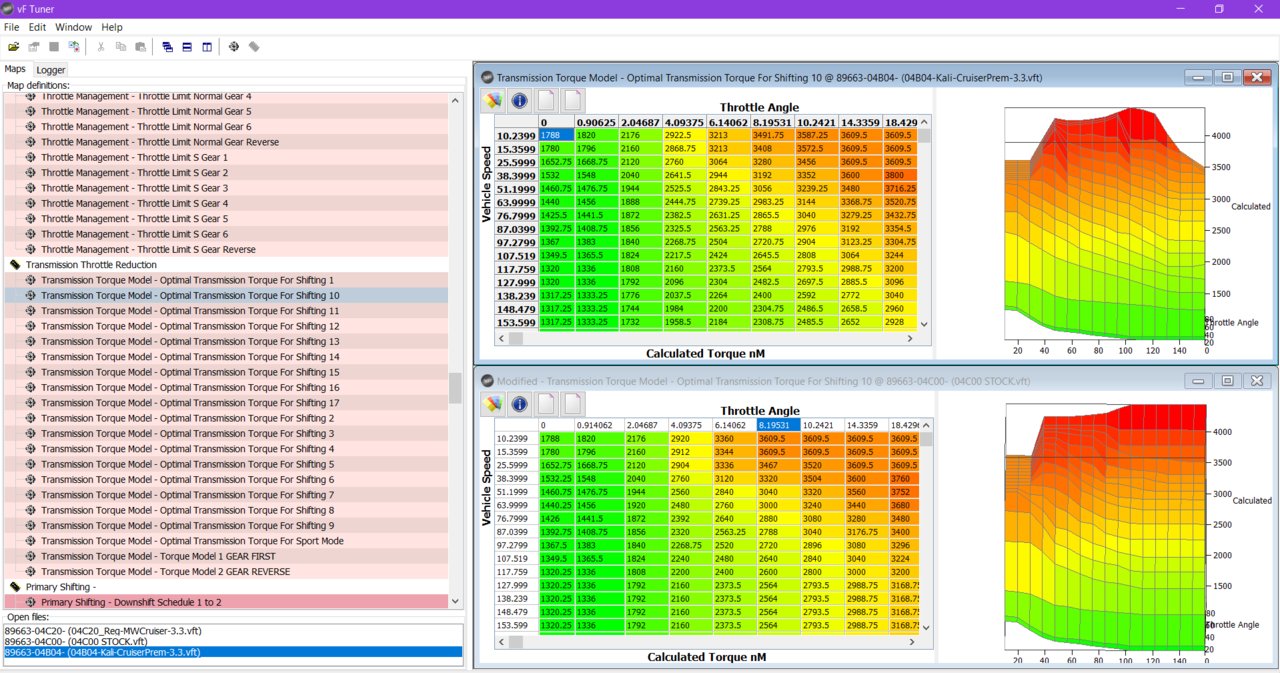

    Just noticed while copying some files that the torque 10 table/map is much higher in the Stock 04c00 tune than in the 04b04 tune.
    I remember Ovtune telling us to increase this (and we did) but obviously not enough. So my suggestion is to use these torque 10 settings (like in 04c00).
    I certainly am.

    Could you get all of them into the spreadsheet?
  8. Jan 22, 2021 at 12:21 PM
    #1048
    PapaRee
    PapaRee Pro Tuner
    Oct 31, 2015
    #168275
    3,248
    Kreg
    Prairieville, Louisiana
    2016 Black TRD Sport, Tuned, BHLM OEM LEDs
    GTS Dobinson's lift, 33"-Wildpeak Atw3-18x9 -6 Offset ,265/70/18 tires, Raceline Assault wheels, Backflip G2 bed cover, Magnaflow exhaust, Pro tail lights, Pro fog lights, Pro grille, Raptor grille lights, Predator side steps, RedLine Hood Struts, Toyota bedmat, tinted windows, Retrofitted-BHLM-Amber Halo-Amber DRL-HID headlights, LED Highbeams, LED Hood Scoop lightbar, LED hidden bumper lightbar, LED under hood light, LED Bed lights, LED license plate lights, Tacoma tailgate 3d letters, Tacoma glovebox 3D letters, removed air dam, Custom TRD Sport emblems, Pro Shift Knob with Meso ECT Stealth button, Meso LED dome and map lights, Meso V3 smoked mirror turn signals, Meso Stage 2 Tail lights, Meso Mirror Puddle lights, Meso KC-5 Brake/Cargo light, Meso center console bucket with OG lid, Tailgate PNP kit, Garage door opener button in overhead console, Meso Minimalist keyfobs, Matte black Pro hood decal, KTJO4x4 Led door handle LED lights, Pioneer 6x9 3 way front speakers, Rockford Fosgate 6.75' rear speakers, TacoTunes tweeters, AJT black vent rings, JDM Gas cap cover.
    Yes.
    I just copied the table and pasted.

    v3.3 for 04B33 - also added the torque 10 settings posted by @PapaRee
    Mooseditty17 and wahoobie like this.
