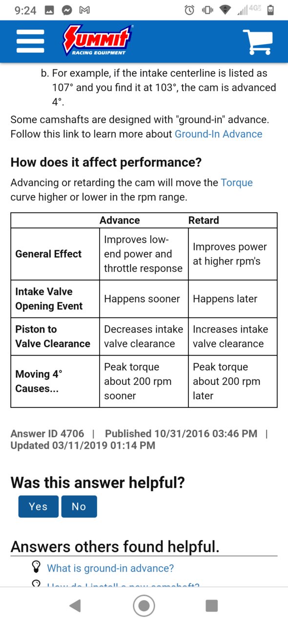

    The vvt changes help with high load low rpm situations

    But like how does it help? Not trying to sound arrogant, just genuinely curious. I'm also super curious how you're learning all this stuff!

    I tried explaining it by saying--- we are making the high engine load, lower rpm area have more power by increasing the intake valve angle, more direct injection (from fuel injectors) at high load, and adjusting the atkinson compensation map.
