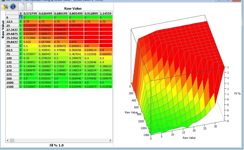

    I'm done with "tuning"...until anyone can show me better #s while doing 75 on steep incline in 5th, CC is On.

    I see that intake valve at 75 degrees. That is what helps! Stock will only get to 65 degrees.

    Very interesting. I wonder how it would be 5.29s as we're normally cruising around 2200 rpm. Guess their is only one way to find out.

    Hmm. Some interesting adjustments going on here.

    I notice afr at 13.5 that's kind of interesting to see it low like that in closed loop operation.

    If it is opened, should it be using one of those AFR tables?

    Could you advise which axis is throttle, and which axis is RPM?

    Is this OBD Fusion? I have it but don’t have half of those displays yours shows.
